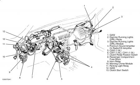

my relay is not workin i want to know where it is so i can change it so my ligth will work during the day

your vehicle's daytime running lights (DRL) relay is located above the right kick panel
