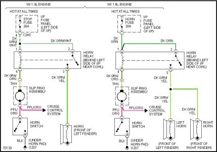

1995 Ford Escort Horn need the wiring diagram
1995 FORD ESCORT
BERTRAVEN278
Electrical problem
1995 Ford Escort 4 cyl Two Wheel Drive Automatic
The connection to the hor fell off I need to follow the wiring to the front of the car.

https://images.2carpros.com/forum/automotive_pictures/261618_Noname_1606.jpg
