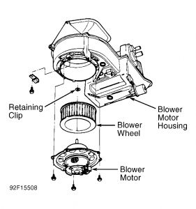

1994 Ford Escort 4 cyl Manual 151000 miles
Blower motor is not blowing, I can feel the heat though.
How hard is to fix or replace?
thanks

check fuse #16 in under dash fuse box BLOWER MOTOR Removal & Installation Remove panel under glove box. Remove wiring bracket and bolt. Remove 3 blower motor mounting bolts. Pull blower motor out of housing and disconnect wiring. See Fig. 5 . To install, reverse removal procedure. Fig. 5: Exploded View Of Blower Assembly Courtesy of FORD MOTOR CO.
https://images.2carpros.com/forum/automotive_pictures/266999_blow_1.jpg

Thanks for the help Dave. I don't seem to have a panel under the dash? But I can see the blower motor housing.
Would I need to replace the basket thing too?

make sure you check the FUSE before replacing the motor
The "basket" is the blower wheel .. it may/may not come with new motor ? it is not necassary to replace it ?
