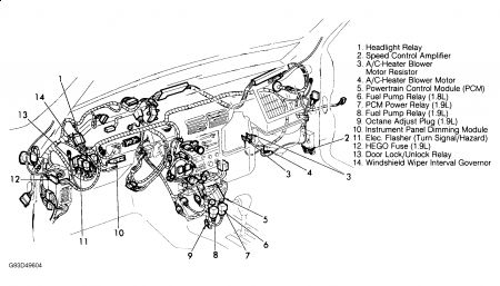

1993 Ford Escort 4 cyl Front Wheel Drive Automatic
My sisters blinkers and hazards do not work. It is not fuse under dash- I have no credit card-but i will donate to a local charity if u want.
Oct 14, 2009 at 2:56 AM
DOCFIXIT
  • 18,828 POSTS
Most likely flasher located left side dash by kick panel
https://images.2carpros.com/forum/automotive_pictures/198357_Graphic_184.jpg
