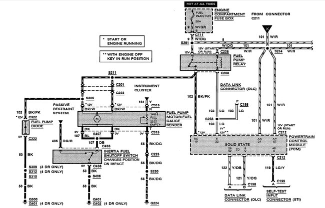

Im trying to diagnose my fuel pump without a Pressure gauge if at all possilbe. Chilton manual mentions checking the Fuel Pump In-Line Harness Fuses. Only one I can find is the main Fuel Injector Fuse (30A). In the picture in manual it shows an (15a) and a (5a). Anyone know where I may find them even if they exist for the car?? Also is there a way to test without an Pressure guage??

Not sure what you're up to but if the fuel pump is not coming on make sure you check the safety switch(for rollover/accident protection) usually on the inside of the rear fender well. If this switch is tripped(just push the red button to reset it), the fuel pump will not work.

There is no "in line" fuse just a diode on the ground wire, I would check the inertia switch which should be on the right side near the kick panel (front) here is the wiring diagrams so you can check it out yourself. Check out the images (below). Let us know how it goes
