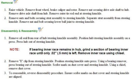

I want to grease my front wheel bearings,,I have the proper socket for the large nut to remove it,,,but it does not seem to move,,seems there is a small indention keeping the large nut from moving,,is it a stop to prevent the large nut from moving? how can I remove this large nut and get to the bearing. Thanks , Richard

To remove wheel bearing you must remove the hub & steering knuckle assembly. Procedures are below..
https://images.2carpros.com/forum/automotive_pictures/261618_Noname_975.jpg
https://images.2carpros.com/forum/automotive_pictures/261618_Noname2_272.jpg
