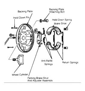

My brake light keeps coming on so I took it to a mechanic and said my brake cylinders need to be replaced. I hear its an easy fix can you show me how?

Its not as easy as you may think !
jack and remove tires a
remove :
rear brake drums
remove springs and hold down
remove shoes
loosen and remove brake line
remove cylinder hold down
remove cylinder
reverse procedure for installation
then bleed the brake system
https://www.2carpros.com/forum/automotive_pictures/99387_escort_wheel_1.jpg
