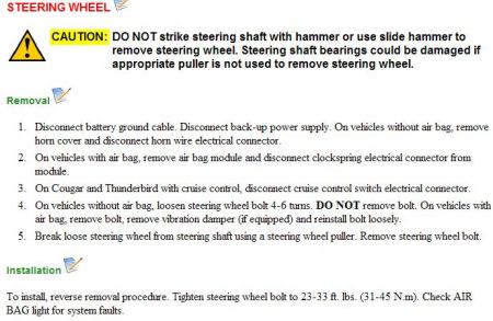

1991 Ford Escort Steering wheel removal
1991 FORD ESCORT
120,000 MILES • 4 CYL • FWD • AUTOMATIC
JON NESS
Is the steering wheel held on with a snap ring or retaining ring of some kind? After removing the bolt and using a puller it won't move.

https://images.2carpros.com/forum/automotive_pictures/261618_Noname_1056.jpg
