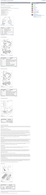

Hello, my vehicle listed above hybrid won't go to EV mode. there is one DTC
P0A81 Hybrid Battery Pack Cooling Fan 1 Control Circuit/Open.
which one is number 1 fan?
May 19, 2020 at 1:41 AM
BMDOUBLE
  • 1,139 POSTS
The code for fan number one is a mistake on the repair manual because both fans share the same circuits and are not numbered. There is a service bulletin to replace both fans for this code. I have attached the service bulletin.
