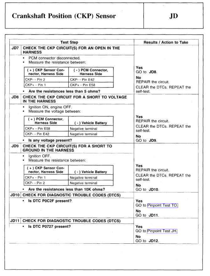

Hello, I bought this vehicle. It starts but only in hybrid mod and gas engine won’t start. There is code P0727 Engine Speed Input Circuit No Signal.
Crank sensor is bad? Or harness problem also where is speed sensor located?
Sep 5, 2019 at 6:49 AM
This is the most likely cause. However, it could be wiring, TCM, PCM.
If you want to go ahead and try the crank that will cut down on diag time if the guess is correct. However, at this point it is just a guess.
I attached the diag procedure for you to follow if you would like to confirm what the issue is first.
Let me know what you find or if you have questions and we can go from there. Thanks
Sep 5, 2019 at 10:23 AM
