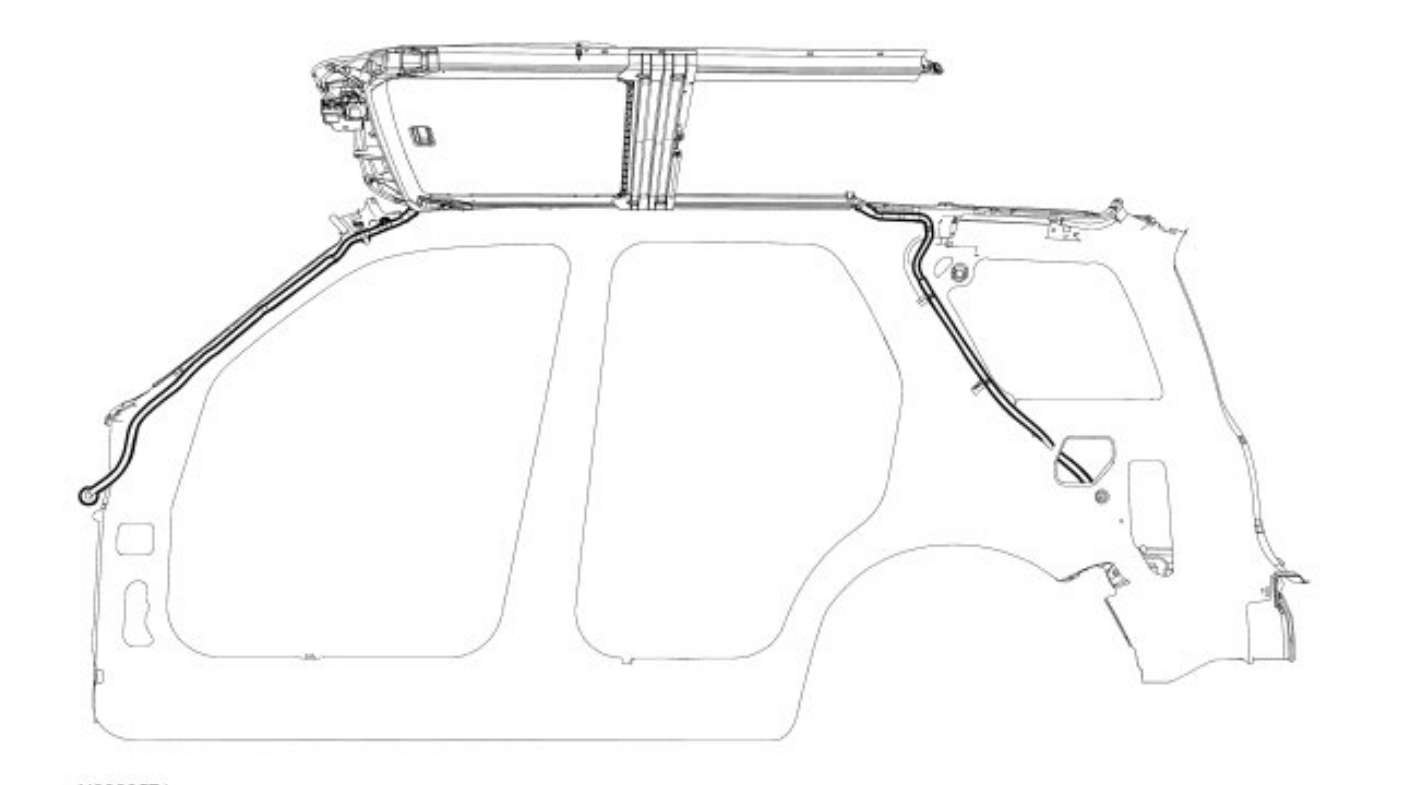

Does the car have a sunroof? If so, there are sunroof drains that run down the inside of the pillars which sound like they have come undone, here is a diagram of what I am talking about. You will need to remove the headliner to inspect the condition of the drains. Check out the images (below). Please let us know what happens.

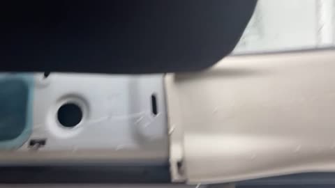

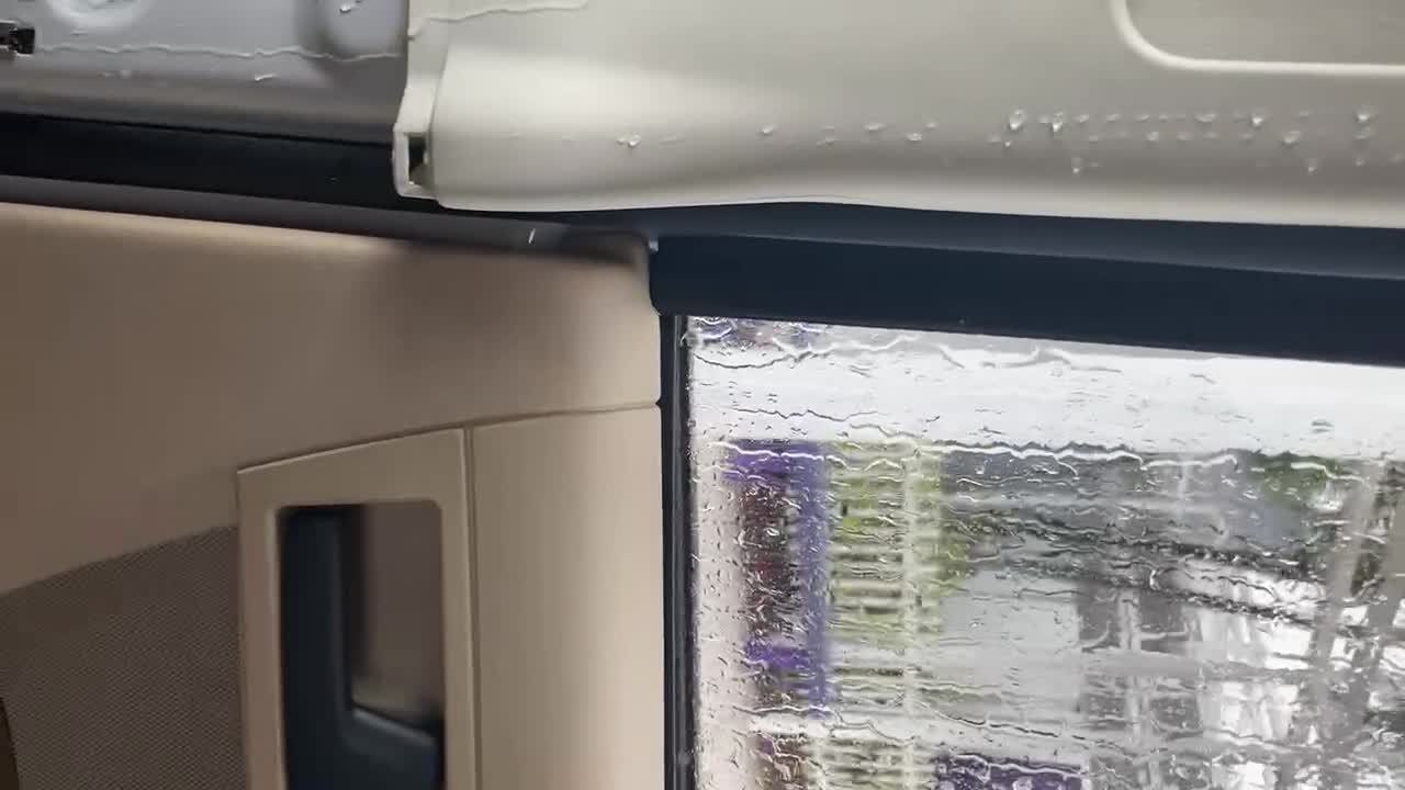

Here is a video.
Apr 20, 2023 at 3:40 AM
  • 55,433 POSTS
Thanks for the video. Can you see where the leak is coming in from? Is the roof rack missing bolts? That should be an obvious leak. Please let me know.

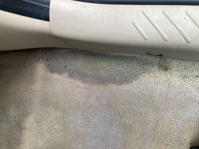

Hi. It does not have a missing screw. But I now noticed in the front passenger side front door floor mat this.
Apr 24, 2023 at 4:01 AM
  • 55,433 POSTS
Yep, that is more water damage. Water must be running down both sides, I would remove the headliner and have a helper use a garden hose to wet down the top of the car until you find the leak. It should be obvious. Inspect the roof for possible problems, can you upload a short video of the top of the car for me? You can upload it here with your response.
