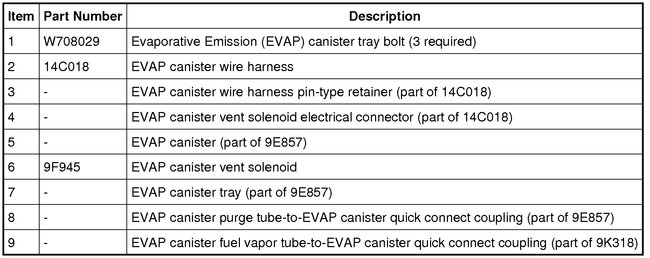

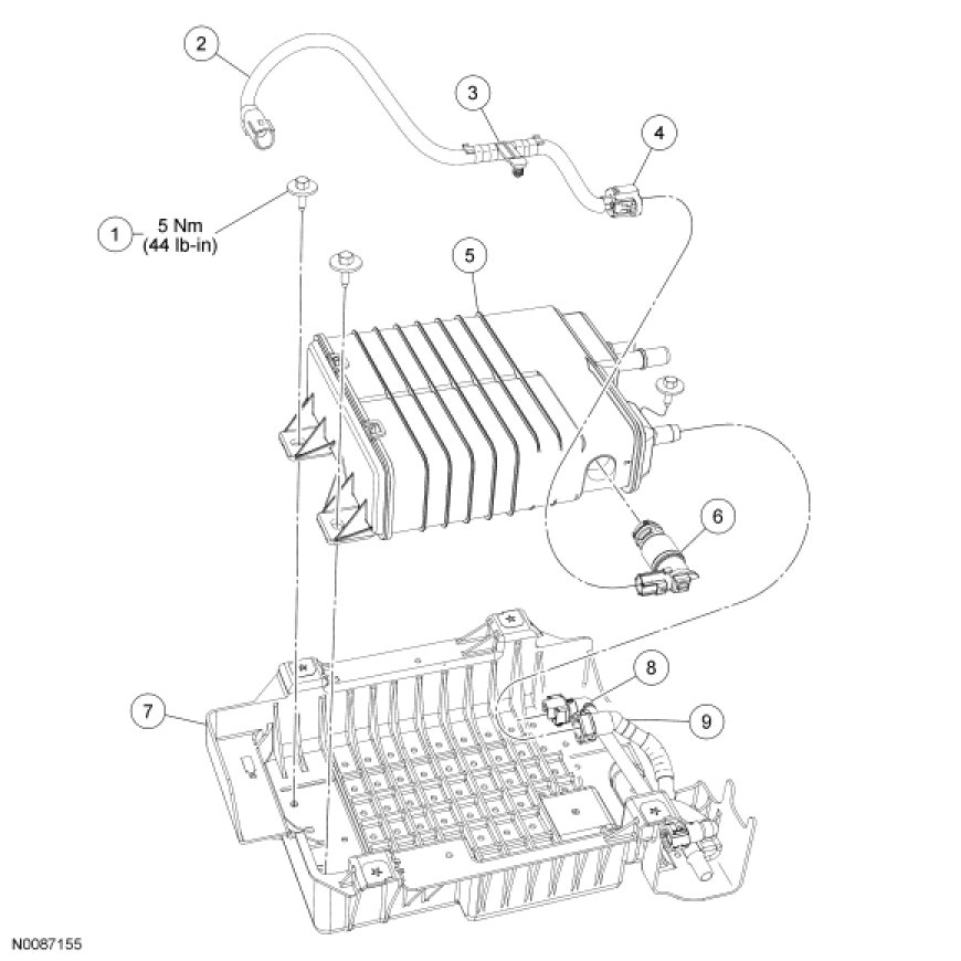

Hi and thanks for using 2CarPros. Com.
Here are the directions for replacement. The attached pictures correlate with these directions.
________________________
Evaporative Emission Canister Vent Solenoid
Removal and Installation
WARNING: Do not smoke, carry lighted tobacco or have an open flame of any type when working on or near any fuel-related component. Highly flammable mixtures are always present and may be ignited. Failure to follow these instructions may result in serious personal injury.
WARNING: Do not carry personal electronic devices such as cell phones, pagers or audio equipment of any type when working on or near any fuel-related component. Highly flammable mixtures are always present and may be ignited. Failure to follow these instructions may result in serious personal injury.
WARNING: Always disconnect the battery ground cable at the battery when working on an evaporative emission (EVAP) system or fuel-related component. Highly flammable mixtures are always present and may be ignited. Failure to follow these instructions may result in serious personal injury.
1. Remove the Evaporative Emission (EVAP) canister assembly. For additional information, refer to Evaporative Emission Canister See: Evaporative Emission Control Canister > Removal and Replacement > Evaporative Emission Canister.
2. Disconnect the EVAP canister vent solenoid electrical connector, release the pin-type retainer and remove the EVAP canister wire harness.
3. Remove the 3 EVAP canister tray bolts.
- To install, tighten to 5 Nm (44 lb-in).
4. Disconnect the EVAP canister purge tube-to-EVAP canister quick connect coupling. For additional information, refer to Fuel Delivery and Air Induction.
5. Disconnect the EVAP canister fuel vapor tube-to-EVAP canister quick connect coupling. For additional information, refer to Fuel Delivery and Air Induction.
6. Remove the EVAP canister from the tray.
7. Depress the locking tab outward, rotate the EVAP canister vent solenoid clockwise and remove it from the EVAP canister.
8. NOTE: Do not apply oil to the EVAP canister O-ring seal. Clean water may be applied to aid reassembly.
To install, reverse the removal procedure.
- Carry out the Evaporative Emission System Leak Test. For additional information, refer to Evaporative Emission System Leak Test See: Evaporative Emissions System > Component Tests and General Diagnostics > Evaporative Emission System Leak Test.

Hi Joe, thanks for the quick reply. I really appreciate it. The reply was helpful as I realized that I needed to remove the canister from the tray. Without doing that I would never have gotten enough leverage or maybe even clearance for removing the canister vent solenoid.

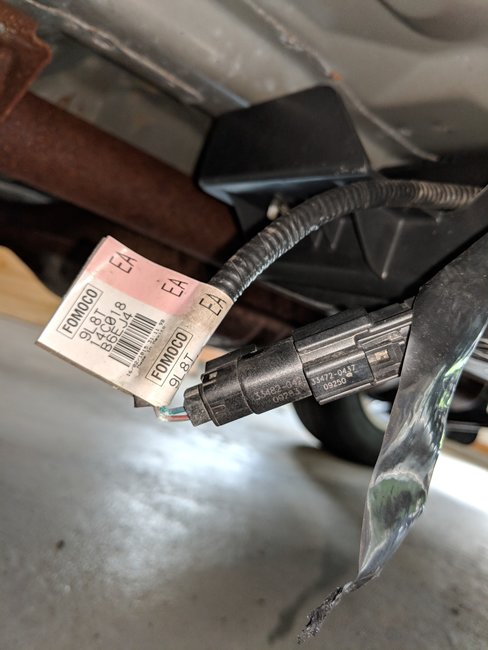

Also, one last thing I noticed when I was putting everything back was this cable looks severely chewed up. I am including a picture. This wiring sits in the tray near number 7 in the diagram you posted here: (https://www.2carpros.com/images/question_images/233352/original.jpg). Please let me know if that could also be an issue for the P0446 code as that will be my next step if the CEL does not clear itself. Also, if that is the case please let me know if you have any information on the part for this wiring and how to replace it.

The picture is fine, however, it is hard to determine where it is going. If I look on a schematic, I will never find them. Can you find where it leads? Also, is there a part number on the tag attached to it? If that is running to the vent solenoid, that could be the problem.
As far as the reset, it should reset after the drive cycle is completed. Most parts stores will test codes for people, but they will not delete them. I am not sure where you are located, but if you purchased the part at a nationally recognized parts store, ask if they will do it.
Let me know what happens. Also, if the wires are not broken under the insulator, I would put electrical tape in each one to prevent a short.

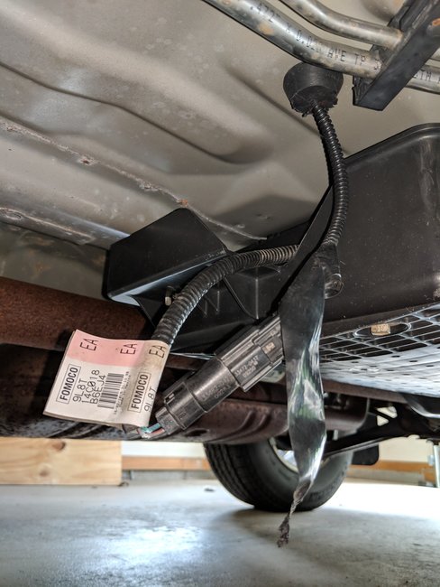

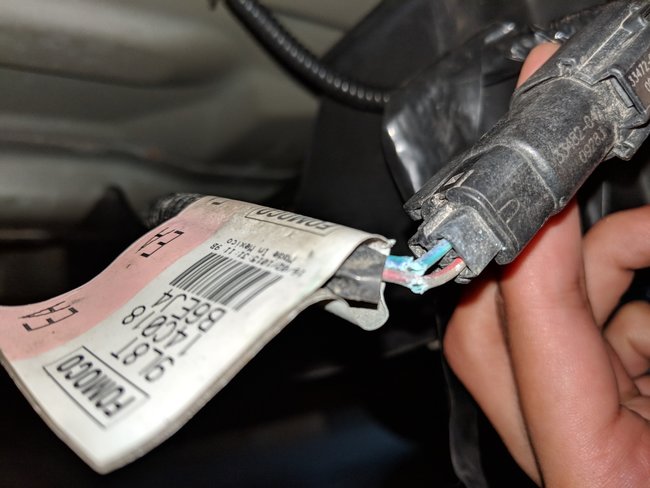

I realized my daughter did not need the Escape today so I went ahead and gave it a closer look. I am including two images. The first shows the tag and numbers on the electrical plugs more clearly. The second shows where the wire is coming from under the body. I felt with my hands and believe the other end leads to the electrical connection on the canister vent solenoid itself. I believe this has to be it!
In fact, if I am understanding this correctly, I could unplug the connection at the canister vent solenoid and then the other end right where the wires are badly chewed up and that entire wiring harness could/would/should be replaced.

Yes, you are exactly correct. According to the part number, that is for the canister vent solenoid. Also, you have connectors on both sides. Either replace it as a unit or repair the wiring.
As far as the light, some turn off right away and others require being reset with a scanner. If you had one, I bet the same code would come up for you. The solenoid wasn't the problem, but rather the wiring to it. So even if you completed the drive cycle, the part is not working due to the wiring issue.
