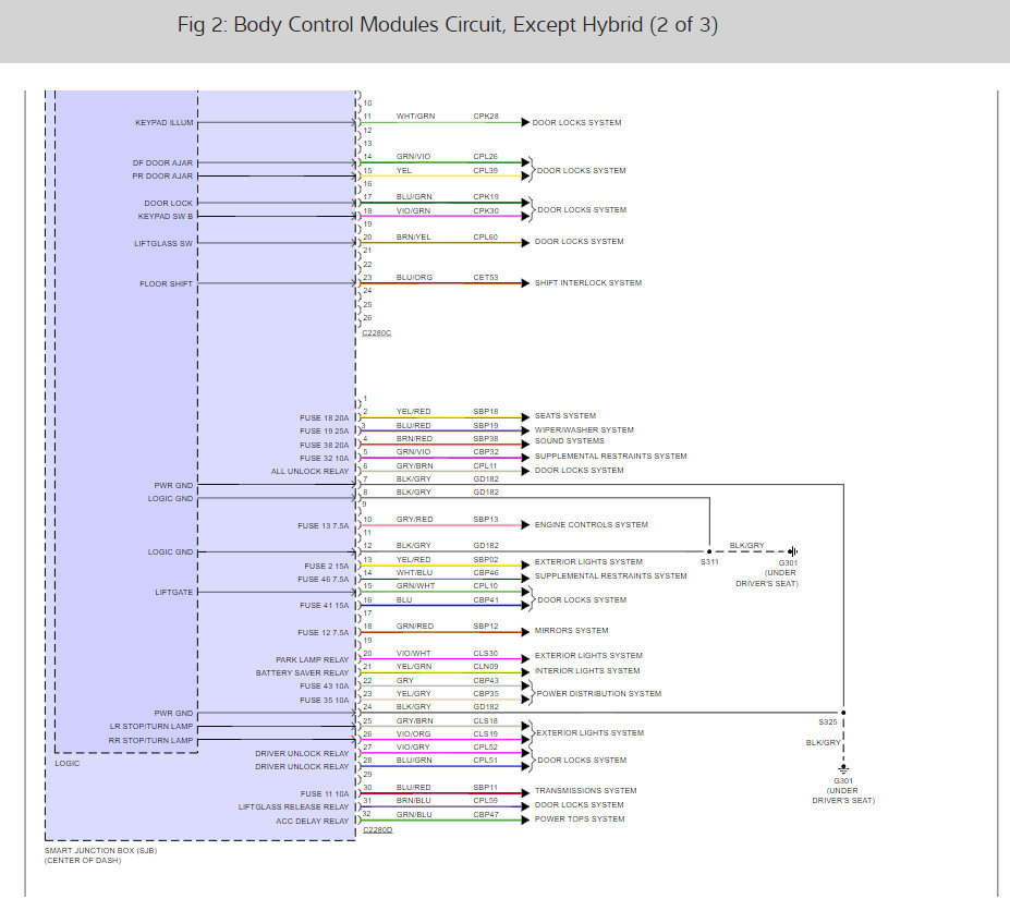

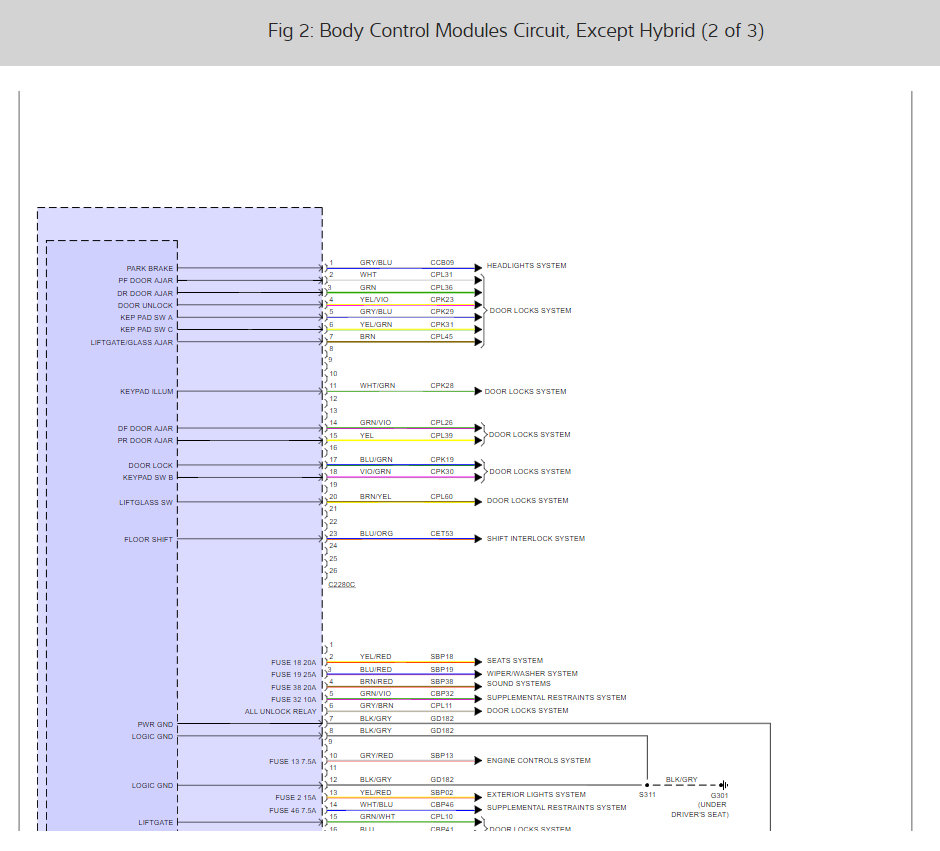

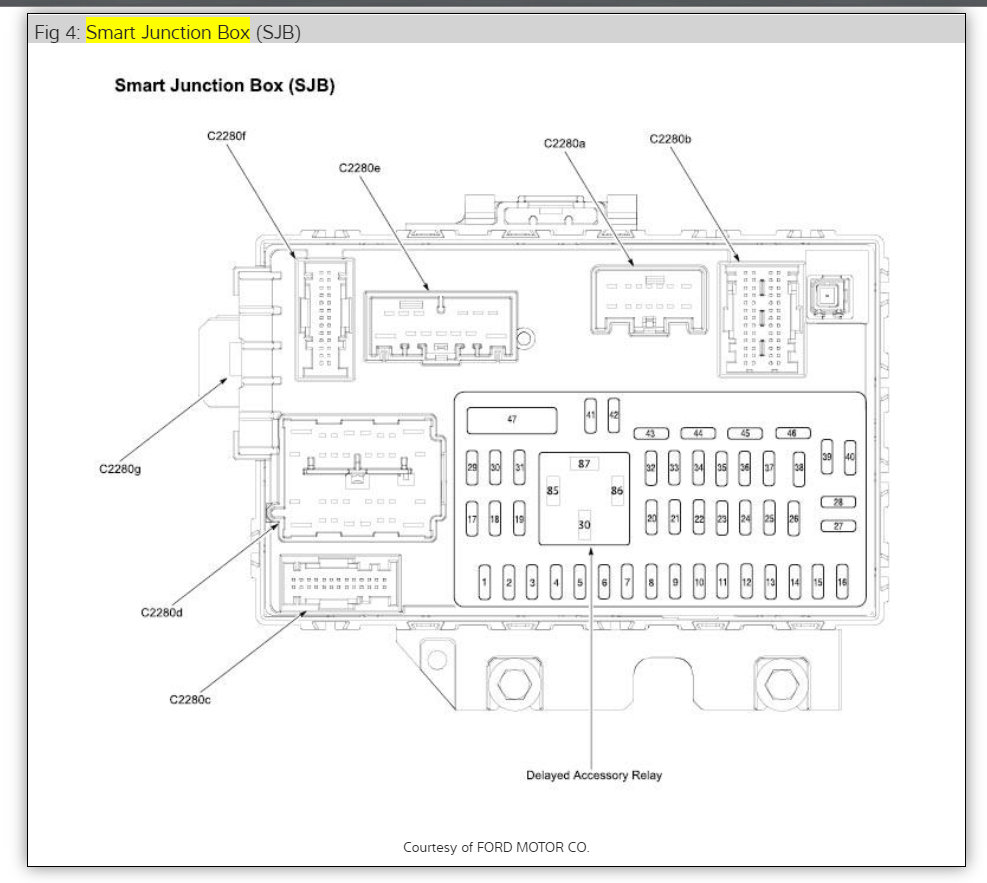

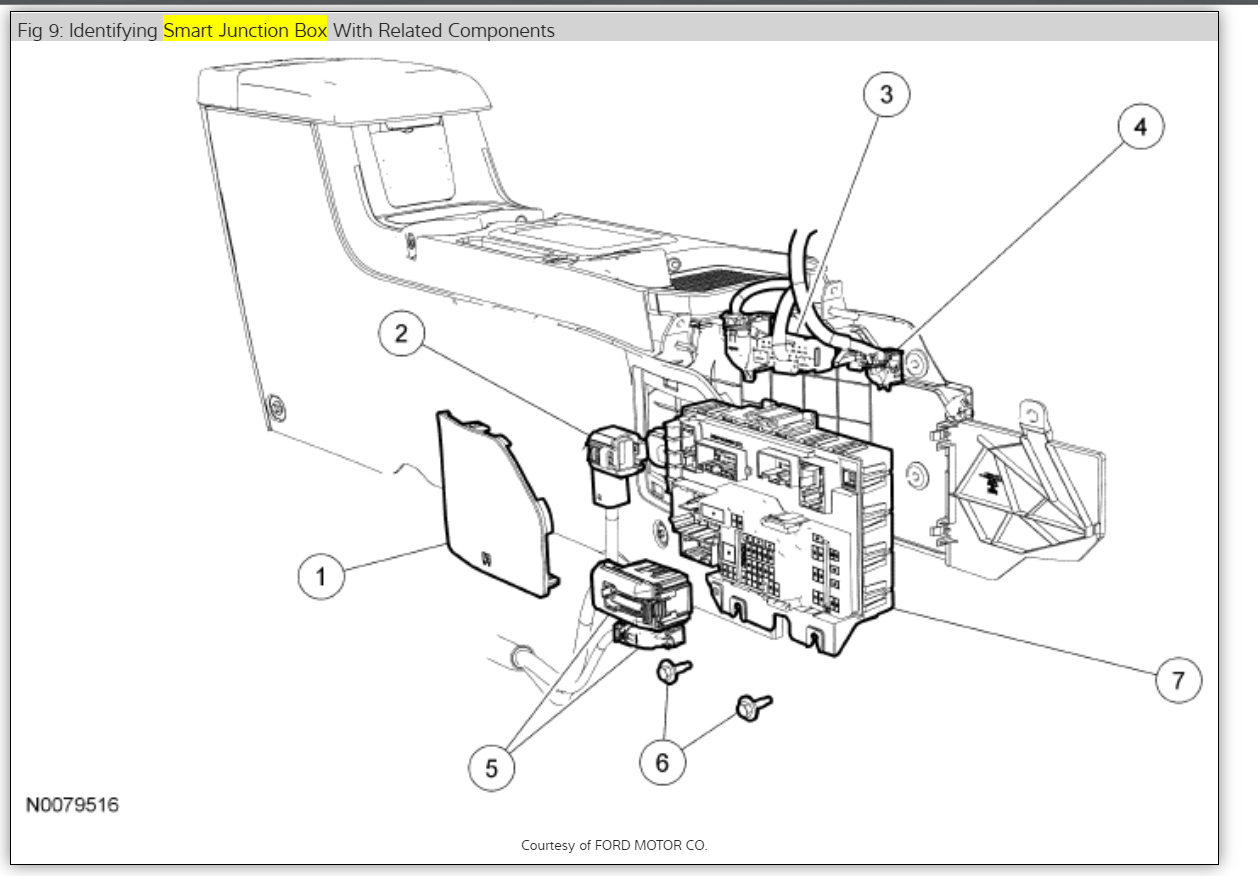

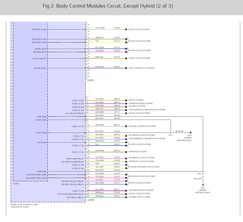

It sounds like you have a problem with the smart junction box SJB. This is what controls the trunk release. Here is a wiring diagram of the SJB so you can see. Also I have included the location of the unit. A shop or the dealer will need to program it for you.
SJB location (below)
