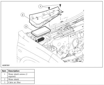

DOCFIXIT
  • 18,828 POSTS
See diagrams
https://images.2carpros.com/forum/automotive_pictures/198357_Graphic_83.jpg
https://images.2carpros.com/forum/automotive_pictures/198357_Grafic_3_20.jpg
NOTE: starting in 2007 filter was dealer potion and may not be on your car.

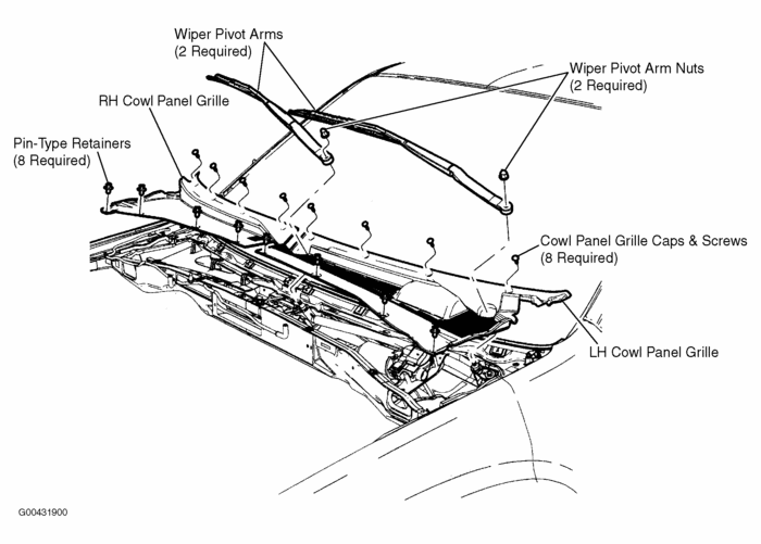

  • 19,053 POSTS
Remove the 2 wiper pivot arm nuts.
Remove the LH and RH wiper pivot arms.
Remove 8 cowl panel grille pin-type retainers.
Remove 8 cowl panel grille caps and screws.
Remove RH cowl panel grille.
Remove the 2 water shield screws and the water shield.
Remove the cabin air filter.
To install, reverse removal procedure.
Adjust wiper pivot arms. Tighten pivot arm nuts
Jun 25, 2020 at 12:26 PM (Merged)

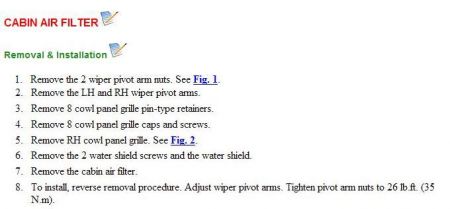

  • 75,992 POSTS
CABIN AIR FILTER
Removal & Installation
Remove the 2 wiper pivot arm nuts. See Fig. 1.
Fig. 1: Cowl Panel Grille & Wiper Pivot Arms
Courtesy of FORD MOTOR CO.
Remove RH cowl panel grille. See Fig. 2.

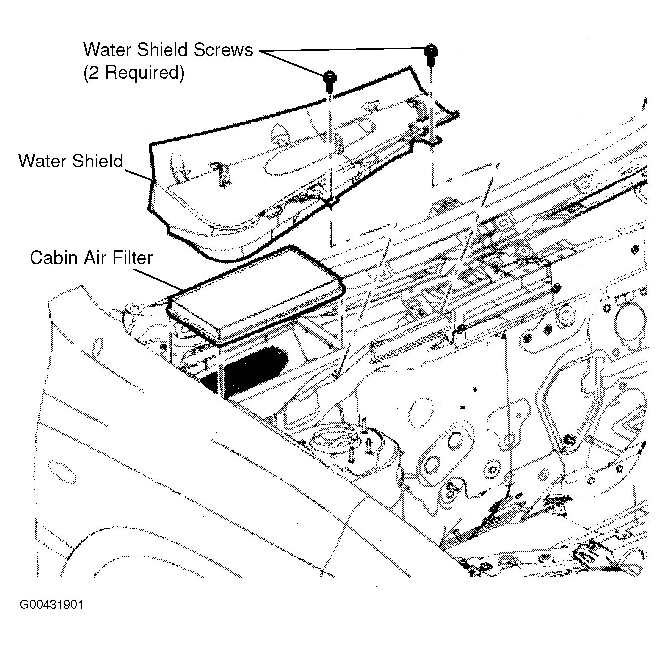

Fig. 2: Water Shield & Cabin Air Filter
To install, reverse removal procedure. Adjust wiper pivot arms. Tighten pivot arm nuts to 26 lb.ft. (35 N.m

BLUELIGHTNIN6
  • 16,542 POSTS
https://images.2carpros.com/forum/automotive_pictures/261618_Noname_1514.jpg
FIG.1
https://images.2carpros.com/forum/automotive_pictures/261618_1_105.jpg
FIG.2
https://images.2carpros.com/forum/automotive_pictures/261618_2_80.jpg
