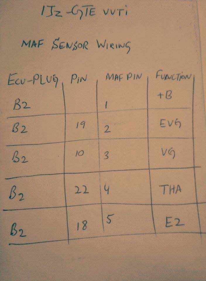

FRAZALI
Toyota 5 pin AFM wiring information (1jz-gte vvti Mass airflow meter )
