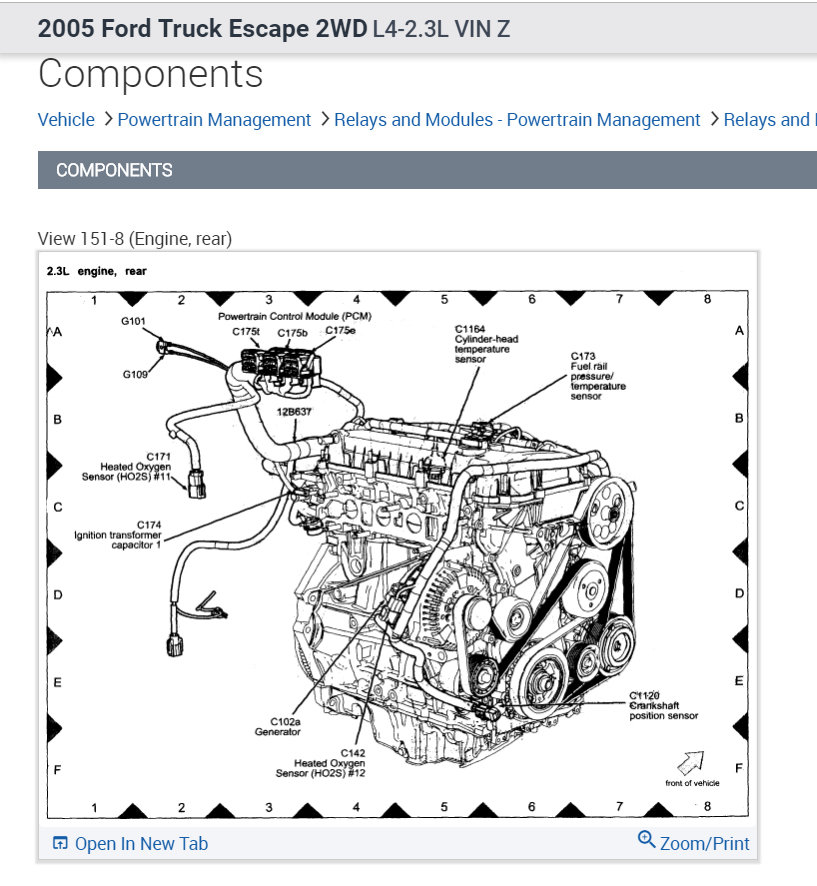

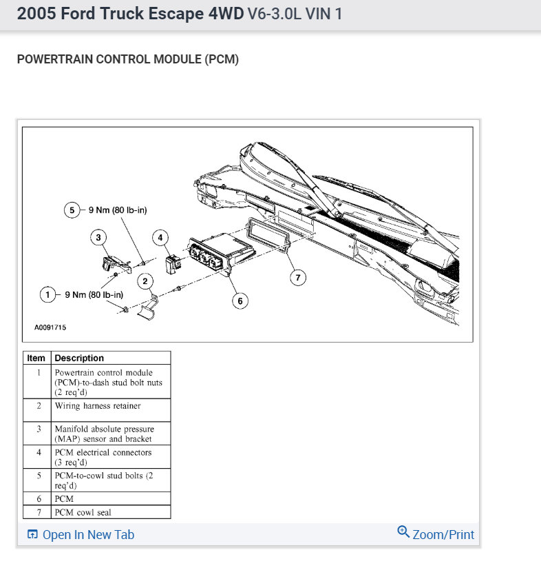

Where is the PCM located in a 2005 Ford Escape? Is there any way I can troubleshoot it/ replace it myself?

The engine PCM is located on the firewall on the passenger's side here are diagrams below to show you the location.

The gem module is a module that controls the body functions.
A wire schematic is available for this car. What system are you looking for?
The pcm is under the hood at the firewall.
