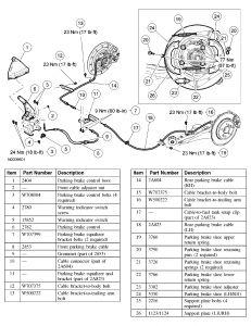

My emergency brake doesn't work at all anymore.I need to know how to access the cable to see if they need to be adjusted or replaced also need to know how to adjust the cable and/or replace cables.Thanks!

Parking Brake Cable Adjustment Release the parking brake control boot clips at the floor console by pressing inward on the base of the boot. Pull the parking brake control boot up and over the lever. Fig. 3: Locating Parking Brake Control Boot Courtesy of FORD MOTOR CO. Turn the parking brake control adjustment nut to adjust the parking brake control stroke. Adjust the parking brake control until the parking brake control stroke is 5 notches when pulled. Verify the parking brake is applied. Install the parking brake control boot. REMOVAL AND INSTALLATION Parking Brake - Exploded View Fig. 4: Exploded View Of Parking Brake With Torque Specifications Courtesy of FORD MOTOR CO.

Parking Brake Shoes Material MATERIALS ItemSpecification High Temperature Nickel Anti-Seize Lubricant XL-2 (Canada CXG-2B)ESE-M12A4-A Removal and Installation Remove the rear brake disc. For additional information, refer to REAR DISC BRAKE . Remove the parking brake shoe upper return spring. Remove the 2 parking brake shoe retaining pins. Remove the 2 parking brake shoe retaining springs. Remove the parking brake shoe lower return spring. Remove the parking brake shoe adjuster. Remove the parking brake shoes. To install, reverse the removal procedure. Using anti-seize lubricant, lubricate the parking brake shoe contact points before installation of the rear parking brake shoes. Lubricate the adjust screw threads with anti-seize lubricant. Adjust the parking brake shoe and lining. For additional information, refer to PARKING BRAKE SHOE ADJUSTMENT. Check the parking brake for normal operation

how do i adjust the e brake i tried to but it's different from the old backer plate adjustment.

PARKING BRAKE CABLE (ESCAPE) 1. Count number of notches it takes to fully apply parking brake lever. If parking brake is fully applied, 3-5 notches, parking brake adjustment is okay. If parking brake requires adjustment, go to next step. 2. Parking brake cable is adjusted at parking brake lever. Remove center console. Ensure parking brake is fully released. Tighten adjusting nut at parking brake lever until adjustment is within specification. Install center console. Check parking brake operation.
Check rear shoes, if worn, parking brake may be out of adjustment.
