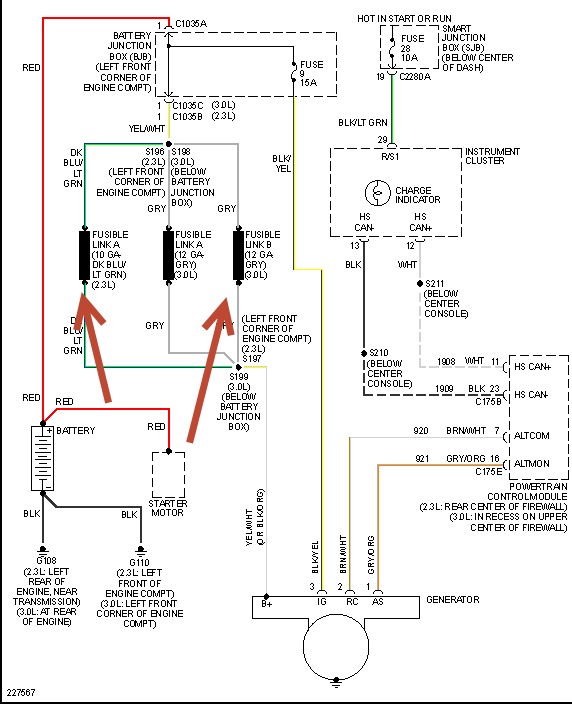

Having similar issues in my wifes 06 escape 2.3 duratec to those in this focus thread: http://www.focusfanatics.com/forum/showthread.php?t=261352
Battery warning light keeps coming on mostly at idle. Battery and alternator have both been replaced.
I don't appear to have a main fuse but a metal "shunt" which goes across the 2 big wires that go to the under hood fuse box. We took it out and cleaned it up as well as tried replacing fuses for things like the alt or pcm. Also swapped around relays to rule those out.
Found the ground from battery to chassis looked a bit corroded to took it of and cleaned up all ends and sanded the connection points. Still no luck. Batt light keeps coming on.
The strange thing is that if I read the voltage with a multimeter from the battery positive and ground to the engine block it shows 14+ volts while running. If I ground the multimeter to the negative batt post or its grounding cable it shows a volt or so lower. Using the odometer voltage display it seems to get the same voltage that is shown by connecting to the battery ground rather than the block. Alternator which was just replaced thinking it was the problem is indeed putting out good voltage. The battery ground looks good and has been cleaned up. What could be causing this difference in voltage output readings?
The batt negative does have 2 leads coming off it. One is to the body that I cleaned up one disappears underneath and looks like it may connect to the engine. Any suggestions what to do from here please? Somehow its losing a volt or so...

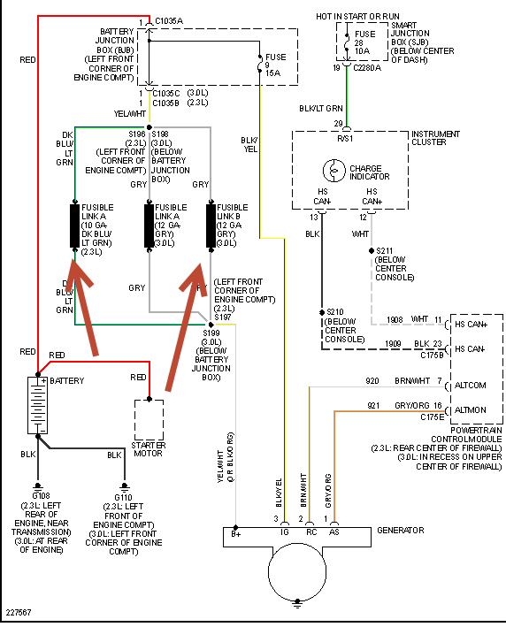

HMAC300
  • 48,601 POSTS
Check your fusible links pointed out in pic, test with a ight or volt meter shold be same voltage for both sides. Also check fuses in picture there are two. This is for a non hybrid if hybrid it's different

HMAC300
  • 48,601 POSTS
The parts i'm talking about are underhood don't waste your time checking he shunt. Look at the pic isentinfirst reply if you have a 2.3L ther eis one an d3.0L there are two. BOTH UNDER HOOD
Thursday, August 3rd, 2017 AT 4:04 PM (Merged)
SUBY6
Thanks for your guidance and diagram! So the voltage seems to be the same on both sides of the fusible link. It's also the same whether we ground the multimeter to the block or batt post.
Discovered that the starting issue goes away if we use jumper cables to add a ground from the battery to block. I will replace the 2 grounds.
The strange thing now is that tonight the alternator voltage was the same if we metered it using the block or batt post as ground. The other day it was over a volt higher using the block as ground. Tonight though the alternator didn't seem to put out any more than 12.5 volts. Possibly the rebuilt alt is bad?
I guess we will see what happens after the ground cables are replaced.
