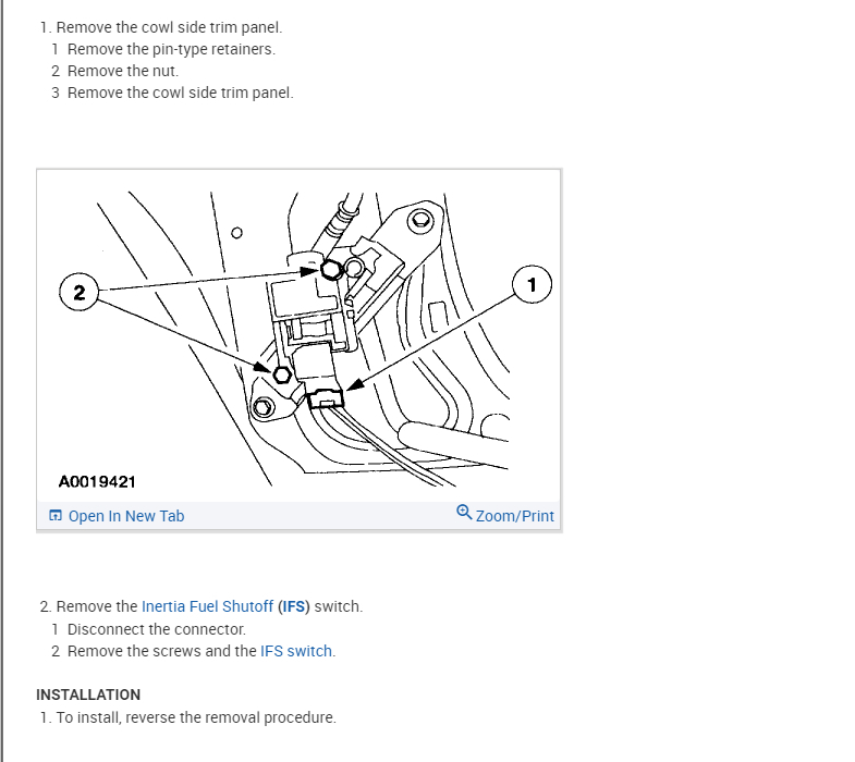

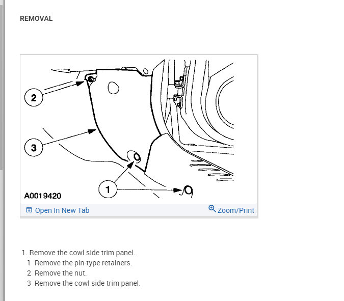

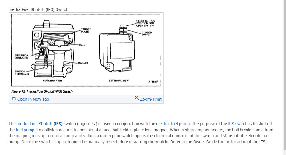

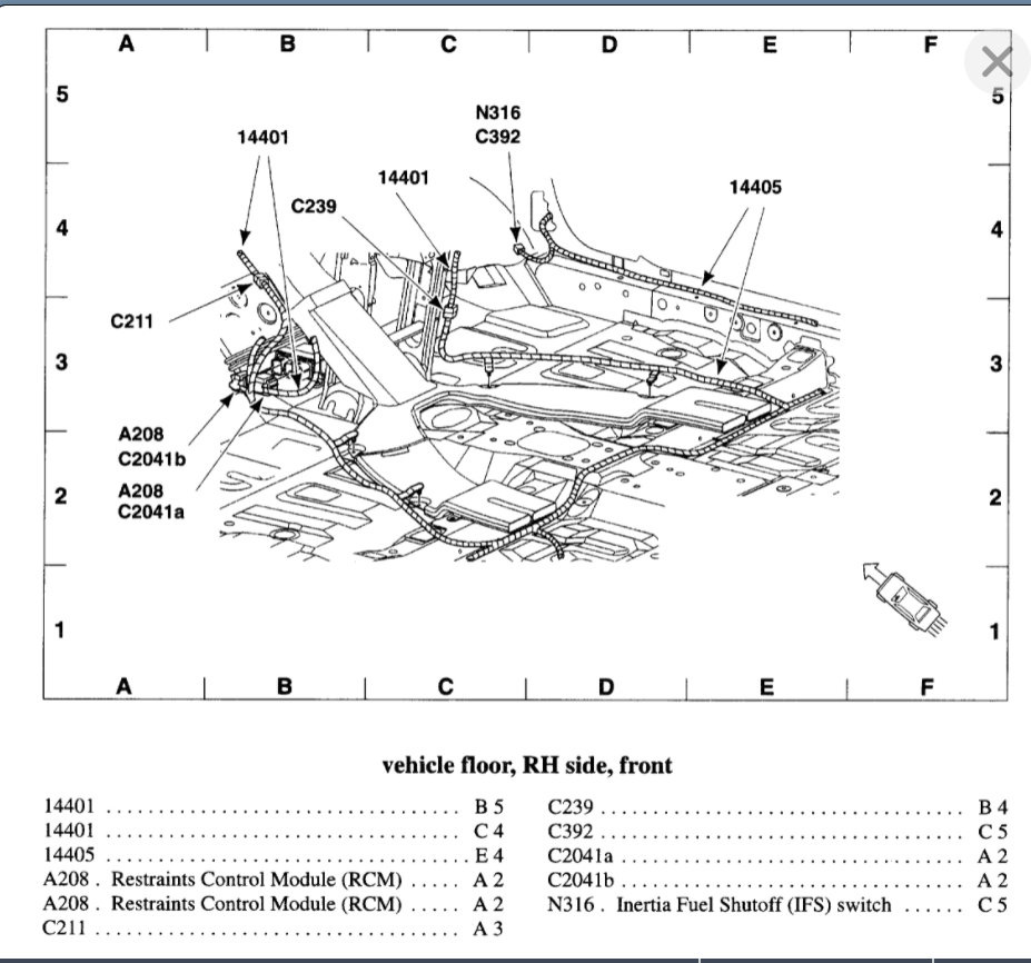

Where is the fuel pump reset button?
May 3, 2008 at 1:19 AM
This is called the inertia switch and I am attaching the info below and is used to cut the fuel off in the event of an accident or rollover.
However, I suspect you have an issue with fuel pressure or the engine not starting. If you do then here is a guide that will help with checking it to be sure:

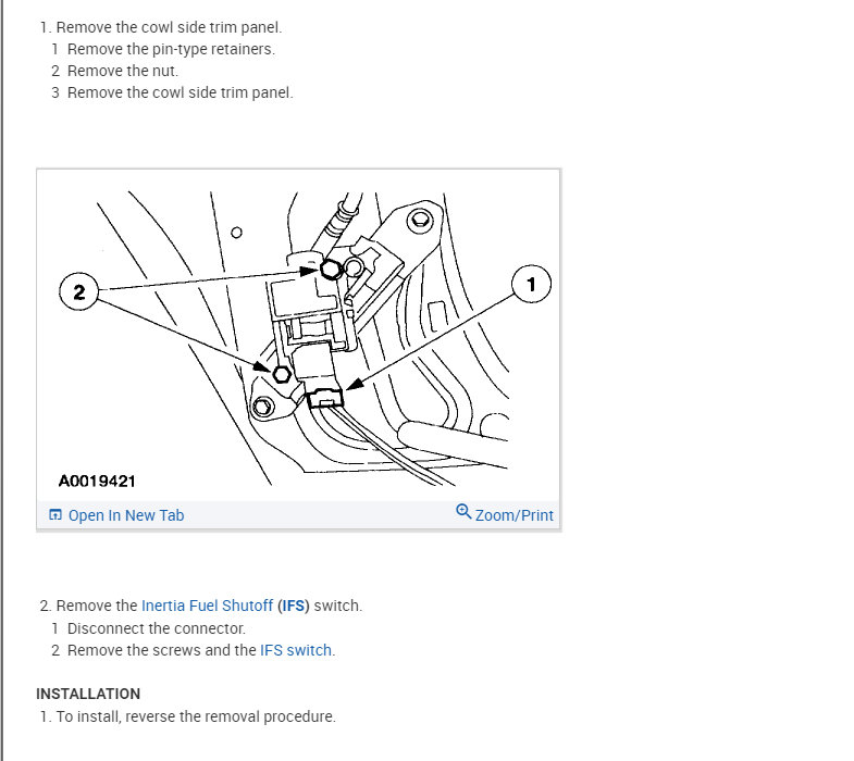

Take a look at the info below on this switch and how to replace it.
