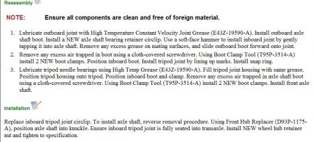

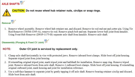

How do I get the driverside half shaft out or release the retaining ring?
