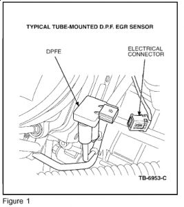

STEVEW84
  • 673 POSTS
What you probably have wrong is what is called a Delta Pressure Feedback EGR(DPFE) Get one from the dealer only. I have seen the aftermarket sensors not work well. HTH.
https://images.2carpros.com/forum/automotive_pictures/170495_dpfe_2.jpg
