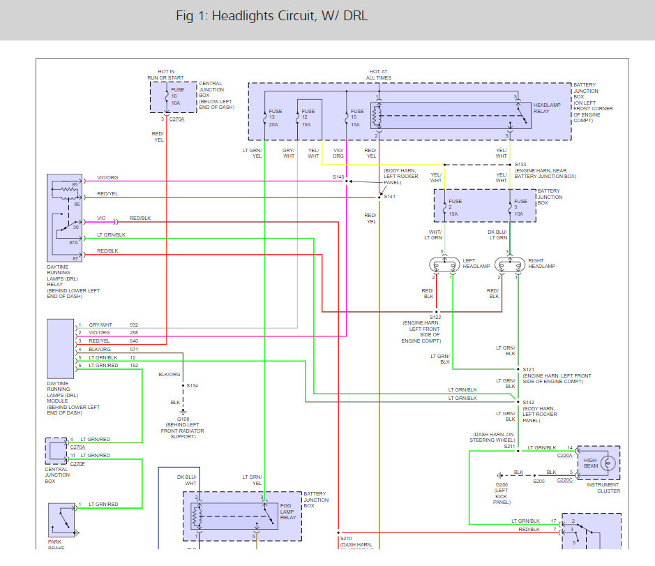

When the vehicle is started the daytime running lights start blinking, what could be the problem, How do I repair it?
Dec 7, 2007 at 11:23 AM
JMW5555

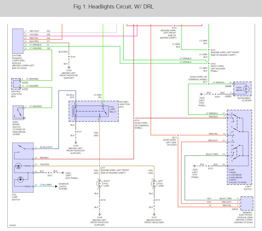

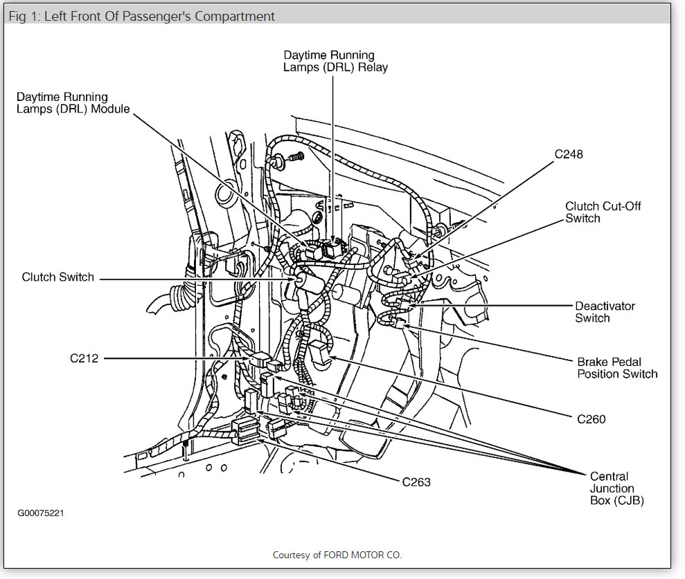

It sounds like the DRL module is going out and needs to be replaced here is the DRL wiring diagrams so you can see how the system works and the DRL module location below.
Dec 31, 2007 at 4:22 PM
ENGR146
Thanks for this post I had the same problem and had to get a new module for $121.00 all fixed I love this site.
