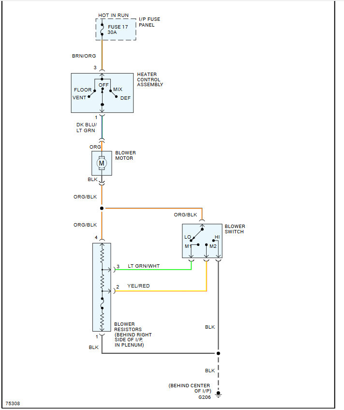

I think this is the wiring diagram for it. Check out the images (below). Please let us know what happens. Ken

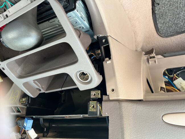

I have got the glove box out of my EL falcon fairmont but I still cannot find the blower
motor. It appears some more trim needs to come off first and I would appreciate some
specific guidelines as I could end up removing more trim then I need to.

I don't have images for this car but we can find it, this car is right hand driver correct? I would use a flashlight to check under the hood and dash, upload the images here and I will help you look.

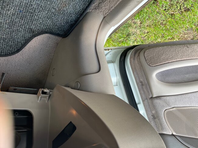

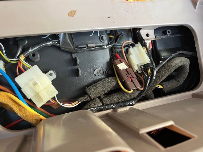

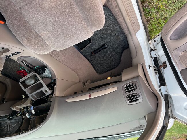

I have 2 EL faimonts - a 97 station wagon and a 96 sedan, the latter still below 92000k
Both are RH drive models. The station wagon also has a dead climate control. The attached pics show the CCU removed again from the sedan because I previously checked for dry joints and I want to make sure I have not inadvertently shorted something out. The previous test drive was at night and everything came alive after a while. The most recent test drive was also at night and the CCU did not come alive after about 15k as before

pic #2
Mar 8, 2026 at 12:57 AM
TONYAIMER
  • 13 POSTS
pic#4
Mar 8, 2026 at 12:58 AM
TONYAIMER
  • 13 POSTS
pic #5

The blower motor it up under the dash on the passenger side, not in the middle. Also, pop the hood and look towards the firewall, ( passenger side) thank for the images it helps.

I dont think you got 2 of the photos.
Mar 11, 2026 at 5:14 PM
TONYAIMER
  • 13 POSTS
here is the final photo. I am battling to find my around this web site.

I seem to be sending the same piciture multiple times. I plan to remove more trim
on the LHS to try and find the blower/motor.

Yep, that is a good one, did you look under the hood at the firewall?
Mar 12, 2026 at 1:50 AM
TONYAIMER
  • 13 POSTS
The blower/fan gets its air from a grill between the hood and the firewall but I will double check this when the rain stops.
