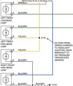

NEED TO FIND HIGHBEAM AT HEADLIGHT. INSTALLING WIG WAG ON POLICE CAR

Best I can do is send you the wiring diagram for 08, 2010 is to new for my books!
