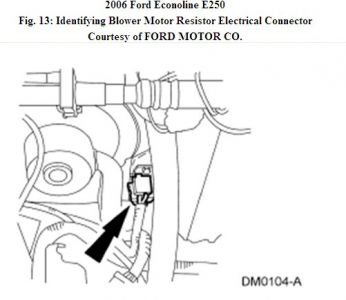

A/C is working but there is no fan controll in the front or rear
Monday, July 26th, 2010 AT 12:21 PM
HMAC300
  • 48,601 POSTS
Chec your fuses and relay first then see if your switch is getting any power or not. It could be your resistor as well which i am sending a pic of where it is. But if both are not working then i'd think it's a fuse or relay.......
