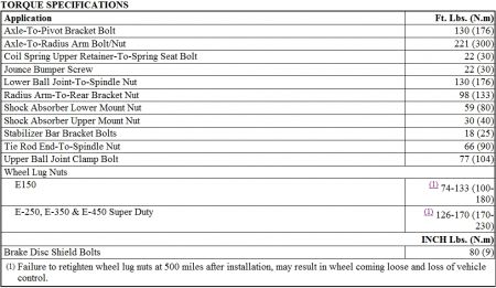

2002 Ford E-Series Van torgue
2002 FORD E-SERIES VAN
119,000 MILES • V8 • 2WD • AUTOMATIC
TATADUNE56
Can you help me find the torgue specs on mounting bolt of the spindle. I replaced a damage spindle. just cant find the specs for torgue.

https://images.2carpros.com/forum/automotive_pictures/261618_Noname_2629.jpg
