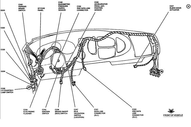

where is the turn signal flasher located on a 2001 e-250 ford van? the turn signals and the emergency flashers will flash once or twice and then stop.
Mar 15, 2009 at 1:53 PM
DAVE H
  • 13,384 POSTS
It is kind of tucked up and out of the way on the drivers side dash, here is a diagram to help find it.
https://images.2carpros.com/forum/automotive_pictures/266999_e1_1.jpg
Please get back to me with any additional information.

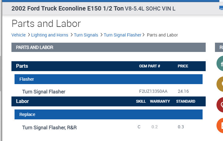

where is the four way flasher switch located
Jan 18, 2017 at 6:42 PM (Merged)
  • 75,992 POSTS
The electronic flasher is located behind left side of dash. Check out the diagrams (Below). Please let us know if you need anything else to get the problem fixed.

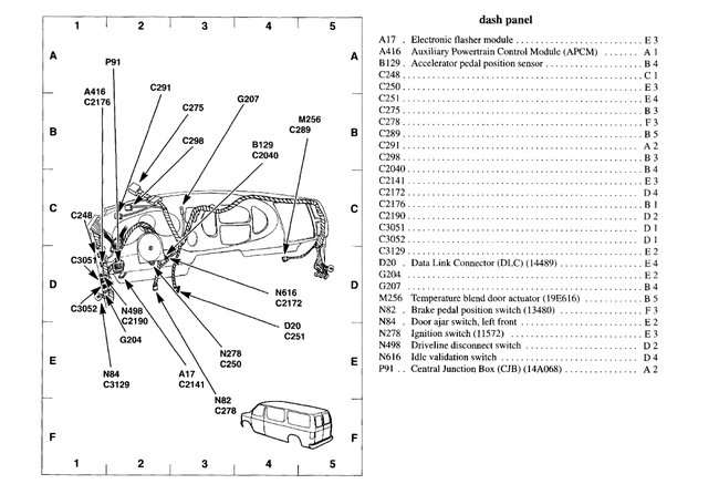

Where is the hazard flasher located on my 1997 ford e150 van? I found the turn signal flasher but cannot for the life of me find the hazard flasher.
Sep 10, 2019 at 9:56 AM (Merged)
  • 75,992 POSTS
The flasher for the hazards and the blinkers are the same unit under the dash on the drivers side here is a diagram (Below) that shows the location for you.
