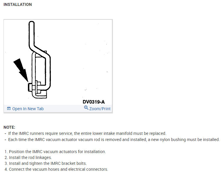

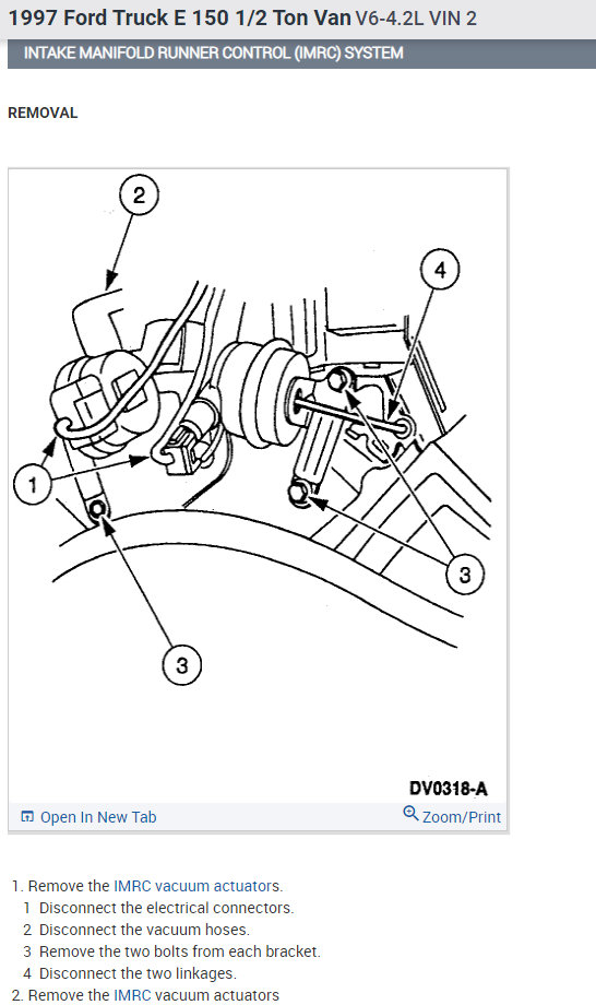

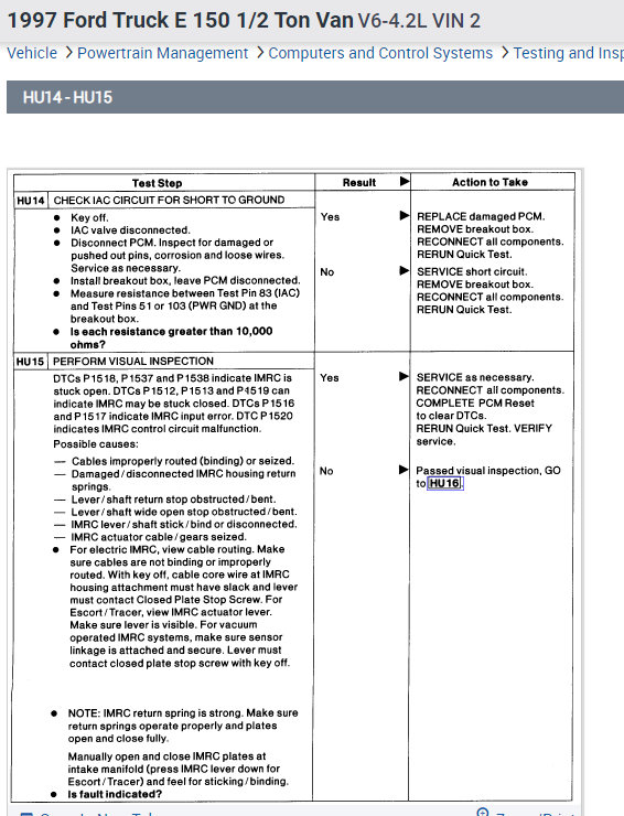

The code P1537 indicates that the intake manifold runner system is stuck open.
It is likely due to a faulty vacuum actuator for the runner system.
It could simply be a issue with the wiring as well.
I have attached the diagnostics for the code as well as replacement procedure for your reference.
