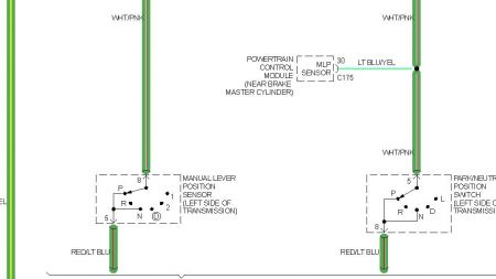

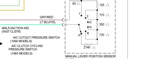

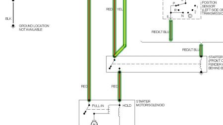

need correct wiring diagram for neutral safety switch on an E40D trans
Mar 22, 2008 at 12:27 AM
AUTOALL
[quote:eb7b2d7a92="autoall"]Transmission problem
1994 Ford E-Series Van 6 cyl Two Wheel Drive Automatic 120000 miles
need correct wiring diagram for neutral safety switch on an E40D trans[/quote:eb7b2d7a92]
Mar 22, 2008 at 1:54 AM
  • 75,992 POSTS
The neutral safety switch is the manual lever position sensor see below circuit
https://images.2carpros.com/forum/automotive_pictures/12900_manual_lever_position_sensor_1.jpg
XXXXXXXXXXXXXXXXXXXXXXXXXXXXXXXXXXXXXXXXXX If you're having problem with starting circuit see below this is for your E40D for a C-6 tranny they called it the Park/Neutral Switch different names but the same functions as the neutral safety switch the old name-
https://images.2carpros.com/forum/automotive_pictures/12900_s1_2.jpg
https://images.2carpros.com/forum/automotive_pictures/12900_s2_2.jpg
https://images.2carpros.com/forum/automotive_pictures/12900_s3_1.jpg
https://images.2carpros.com/forum/automotive_pictures/12900_s4_1.jpg
