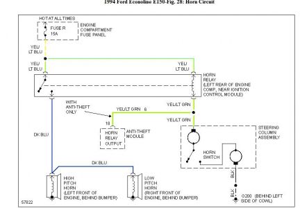

1994 Ford E-Series Van Where is the horn?
1994 FORD E-SERIES VAN
TOMIMIHALYI
I can not find the horn and the power distribution box. Could you help me where these are?
