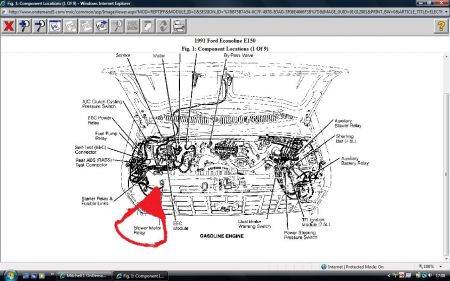

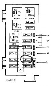

can't seem to find the fuse for the heater fan motor. the back fan motor runs but the front does not. hooked the fan motor up to battery and it works. no hot going to fan motor or switch. can't find a relay under hood either. all fuses in fuse box are good.
updated 3/1/09
Brilliant! I found the relay, replaced it and everything works fine. I should have traced some wires because the same color wire from the motor
goes to the relay. thanks the donation was well worth it.

Hello .. thanks for the donation .. much appreciated Hope this helps .. let me know Blower Motor Relay.....On right front of engine bay, above headlight.

F - 60 Amp Blower Motor, Cigarette Lighter
