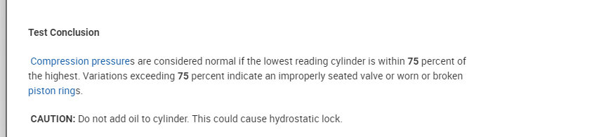

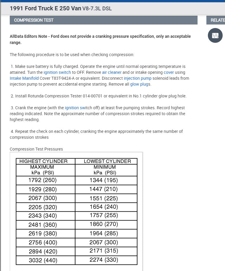

If you have a long crank on diesel then we need to rule out fuel and compression first and foremost.
Here are a couple guides that will help with this issue and the tests that we need to run to start.
https://www.2carpros.com/articles/engine-cranks-excessively-before-starting
Once we know what the fuel pressure is and what the compression is then we will have a better idea what this could be.
Basically, we are looking at injection timing or just a damaged engine with low compression.
The blue smoke tells me that we are getting a build up of oil and fuel due to the excessive cranking so we may have a bit of blow by which should show up in the compression tests.
Please run through this testing and let us know what you find with. Thanks
