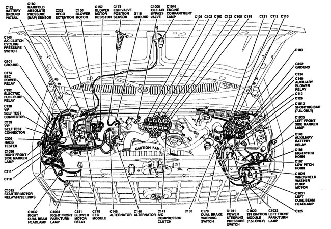

Where is the fuel pump safety reset switch location on 1991 ford econoline van, if there is one?

The switch is called the fuel cut off inertia switch located under the right side of dash, on the heater plenum.
Here is a guid to help you test the relay
And the fuel pump relay is on the right front fender panel near the battery. See below

where can I find the fuel pump reset button?? on a 94 Econoline conversion van 57L V8 w/100K ml ??? and how much fuel should the fuel pump pump out with the filter disconnected. per revolution of the engine???

Don't know where the inertia switch would be. All the book says is that it is located in the cab. Try giving your dealer a call. There is no volume spec for fuel pump output. Measure pressure at the rail. Should be 35 to 45 lbs.

where can i find one?

Behind right kick panel underdash
