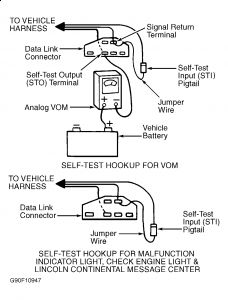

I mistakenly removed my computer mod while replacing heater core. Now it won't start. Fuel pump does not go on. I hooked up a power lead to it. It goes on,albeit a different sound, still will not start. Hooked up code reader. It reads 000, ignition on or off. Any ideas?

It was a OBDI reader, just got an anaolog meter. Have searched my manuals & on this site, still can't figure out how to use meter to get codes
Feb 23, 2010 at 8:21 PM
DOCFIXIT
  • 18,828 POSTS
Hook up like this
https://images.2carpros.com/forum/automotive_pictures/198357_Grafic_3_97.jpg

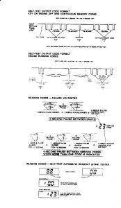

Read codes by counting arm swings
https://images.2carpros.com/forum/automotive_pictures/198357_Graphic_364.jpg
swing pause swing= 11 Also check White fuse link comming off starter relay. Check power to coil

I hooked up meter as described in graphic, thanks, meter pegged. 10vlts direct, with ignition off or on, no movement, just pegged.

What about white fuse link? voltage to coil? hook up as in lower diagram just jumper and observe check engine light

I appoligize, but I cannot clearly read the second chart, tried to enlarge, download to adobe, I can't read it. Is there somewhere else I can look it up. I can only locate 2 relays, side by side, fuel pump & what is looks tobe EEC. It has what looks like 4 fuseable links, that all appear to be intact

Hook up as in lower figure of top diagram Self Test for malfunction indicator light. Did you test fuse links with test light? And was there voltage to coil?
Feb 25, 2010 at 9:47 AM
JMGRIF
  • 17 POSTS
hooked as in bottom of 1diagram, check engine light is on at test & w/o jumper, not that it was before, if I understand you correctly. Fat link is full time 2 others come on w/ignition, 3rd not at all, tested the conneting blk/grn wire, nothing either. I don't have coil in old school sense, like the one my manual shows, this looks like a transfoemer w/other stuff
