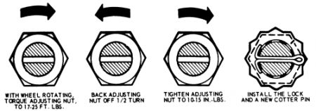

How tight should be without using a torch wrench. thanks for the help

Is this the nut that you are refering to?
https://images.2carpros.com/forum/automotive_pictures/249084_nut_1.jpg
If so, here is the process and you do need a torque wrench:
https://images.2carpros.com/forum/automotive_pictures/249084_tight_1.jpg
Let me know if this helps. Joe
