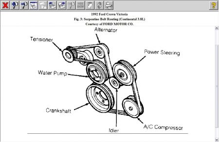

i would like to know where my tenisioner is located on my 1992 crown victoria
Oct 29, 2007 at 6:35 PM
Experienced Mechanic
75,988 POSTS
I got it see below
