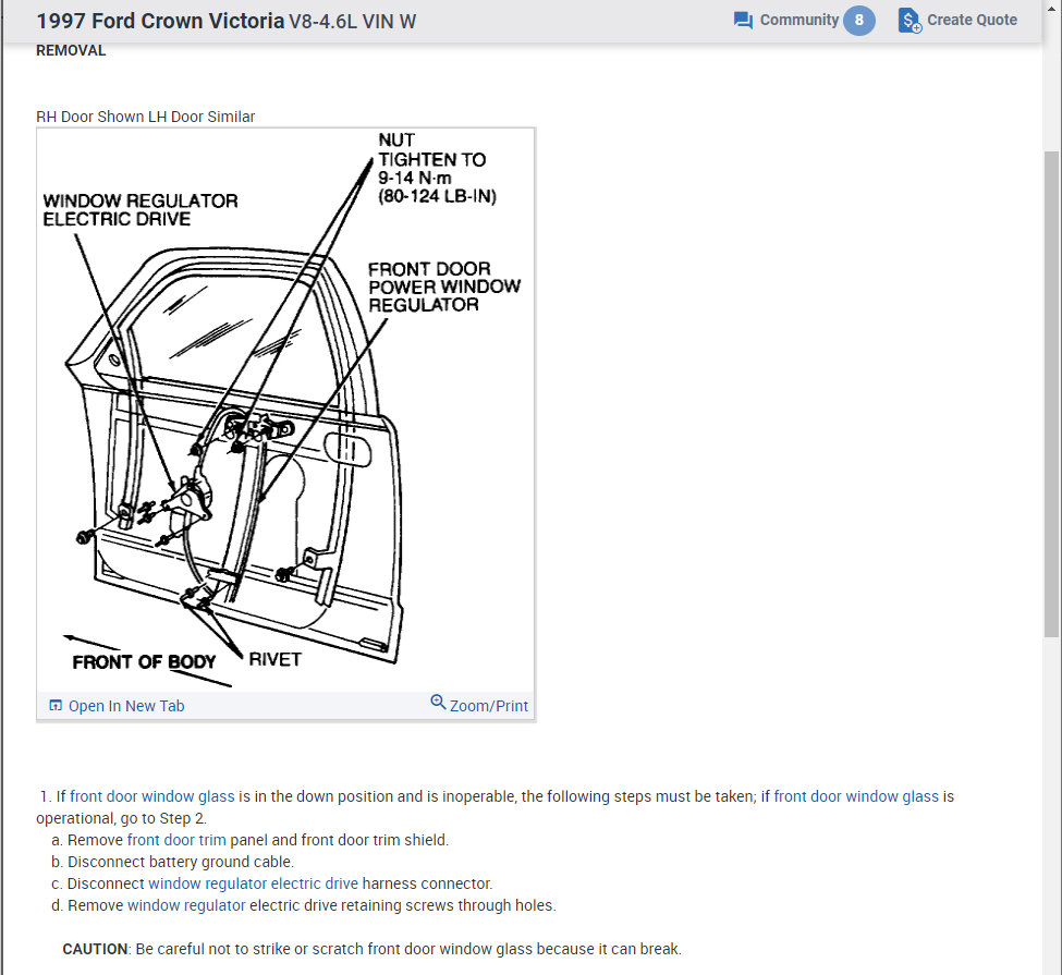

Hi I have 1997 ford crown victoria p71 with 79,000 miles. My driver side window recently stopped working. I don't think it is the motor because it still makes noise and it goes down but not up unless I push against it. What else could be wrong with it? Also if I do the repair myself how do I remove the door panel without damaging it? Thankyou

Sounds like either the motor is getting tired and will need to be replaced or the regulator is gummed up and will need to be oiled. Check the little wheels at each end of the regulator. If you can lift the window with little effort with the motor detached then it's the motor. If the regulator is stuck when the motor is detached you may be able to just replace the regulator. You can find a motor and regulator assembly on eBay for $25

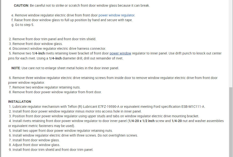

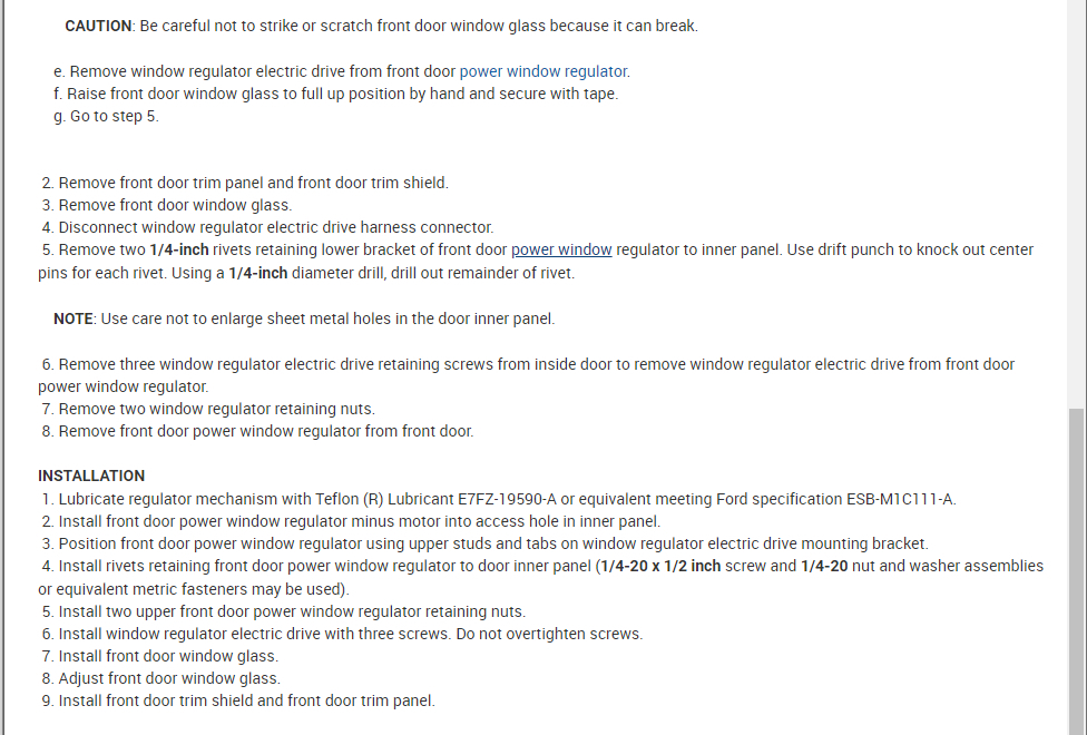

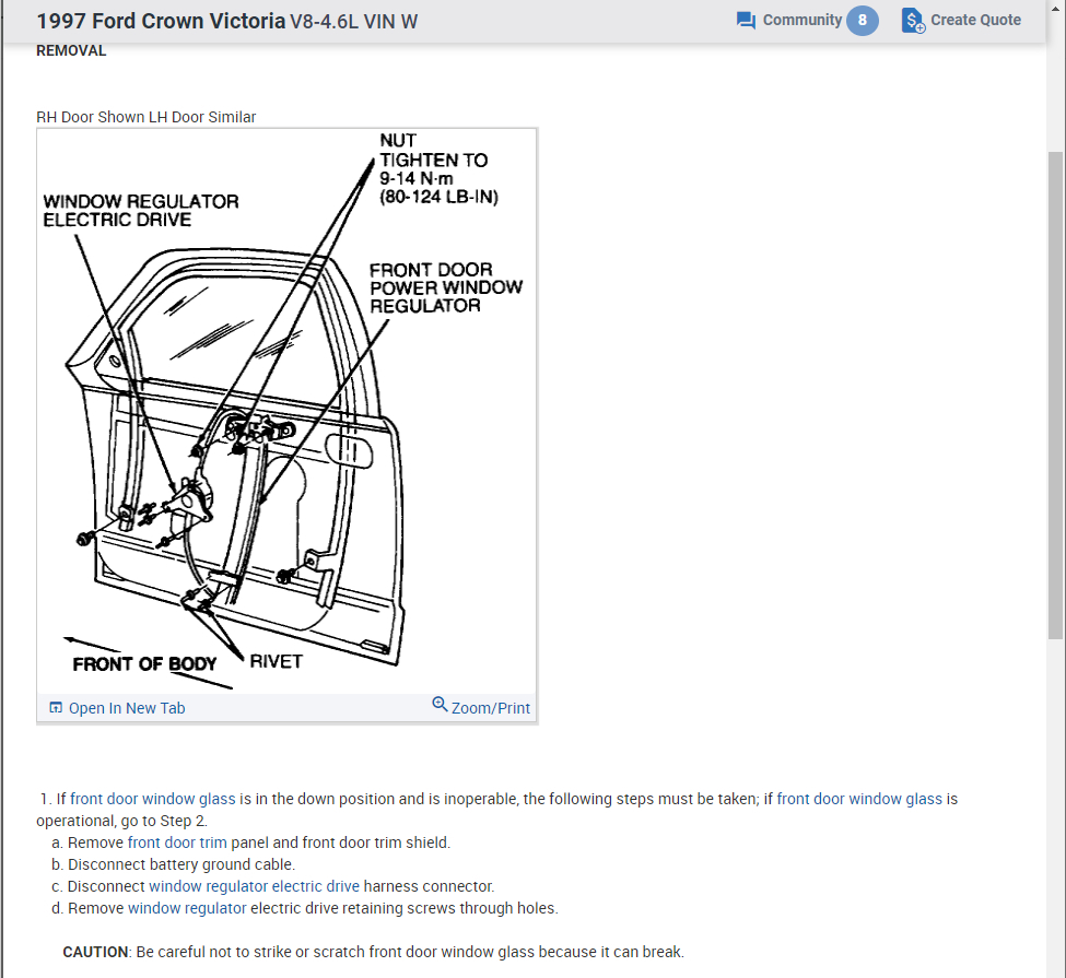

Thanks for the addition to this site. This post is many years old so that info most likely will not help them but it will help others in the future. You are exactly correct that the motor could still be the issue but more then likely the regulator is getting seized and the motor cannot overcome its when it is pressed on, you are removing enough of the binding that the motor can move it.
Here is a guide that will help with this if others need it in the future:
https://www.2carpros.com/articles/door-panel-removal
https://www.2carpros.com/articles/how-to-check-and-replace-a-electric-power-window-motor
Below is the process from the manual that will give the detail that is needed to complete this as well.
