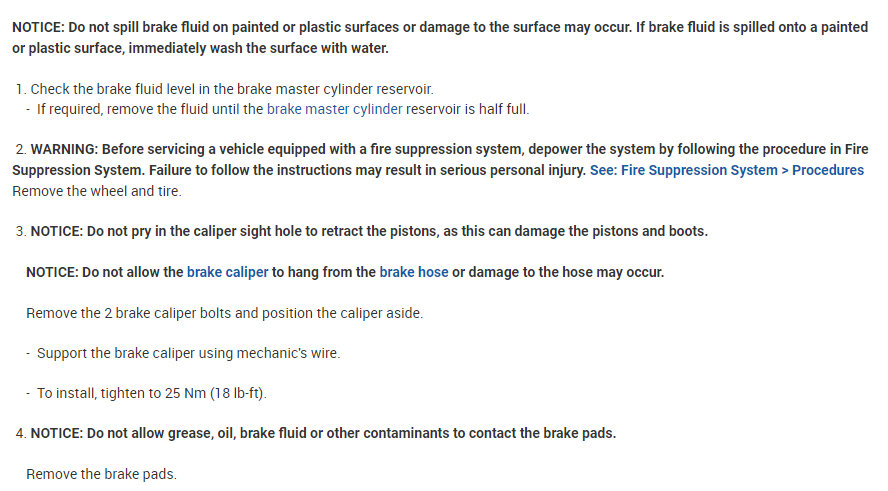

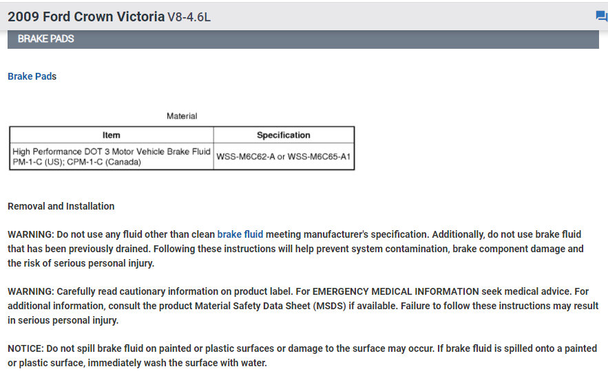

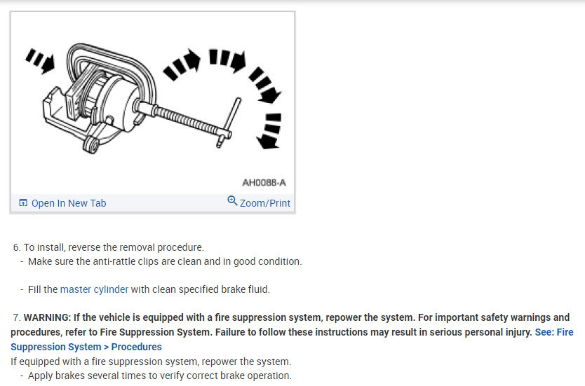

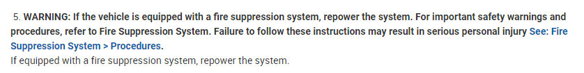

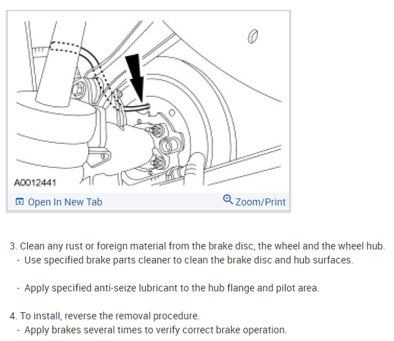

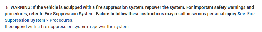

i want to know about doing a brake job?
Aug 24, 2009 at 2:48 AM
DANNY L
  • 5,648 POSTS
Hello, I'm Danny.

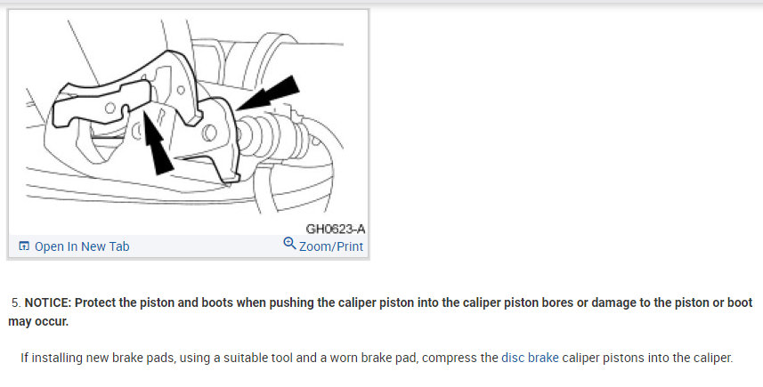

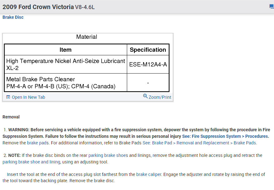

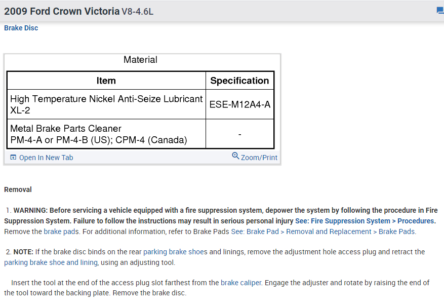

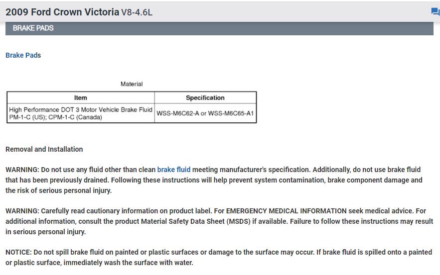

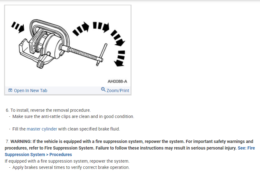

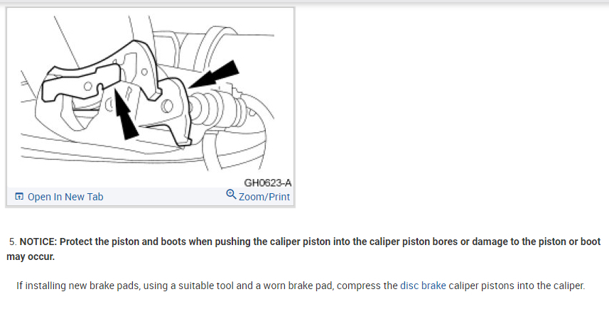

Here is the information you requested. Here is a tutorial on how to remove and replace rear brake pads and rotors: This video shows the job being done on a similar car but the process is the same.
https://youtu.be/ETJvQ-XOfJU
and
https://www.2carpros.com/articles/how-to-replace-rear-brake-pads-and-rotors
Here is a YouTube video from our site on how to compress the rear caliper piston when performing a rear brake job:
https://youtu.be/j8YwfSKEzZo
I've attached picture steps below on how to replace the brake pads and rotors on your vehicle. Hope this helps and thanks for using 2CarPros.
