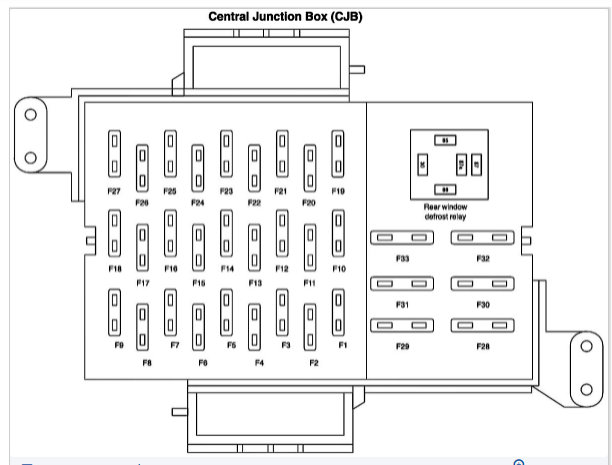

2006 FORD CROWN VICTORIA
89,700 MILES • V8 • 2WD • AUTOMATIC
AWC123

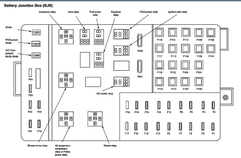

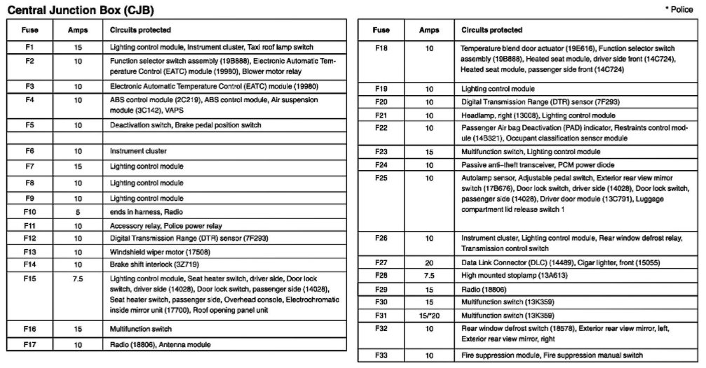

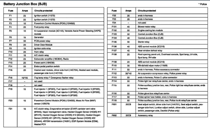

initial trouble codes indicated throttle body, so I cleaned it first, no help, so I replaced it, better but then new code, pedal actuator, so I replaced the pedal assembly, now it sounds like a got a blown fuse where are they and how do you check them?

Hello, I'm Danny.
Here is the information you requested. Here are a few tutorials for you to view on how to check and replace fuses:
I've attached pictures below showing the fuse and relay locations on your car. Hope this helps and thanks for using 2CarPros.
