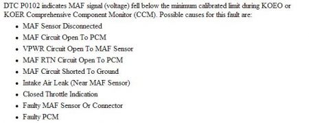

I have a P0102 code returned. MAF voltage low.
Can you give me some idea how to troubleshoot or repair this issue? Have already changed the Mass Airflow Sensor.
