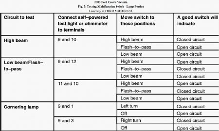

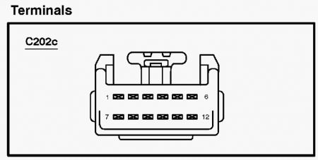

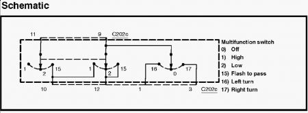

Is the a/c blower motor affected when you hit the gas? Headlights have flash to pass and the brake light wire both go thru the MFS. Test MFS like this:
https://images.2carpros.com/forum/automotive_pictures/62217_MFS1_1.jpg
https://images.2carpros.com/forum/automotive_pictures/62217_MFS2_1.jpg
https://images.2carpros.com/forum/automotive_pictures/62217_MFS3_1.jpg

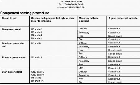

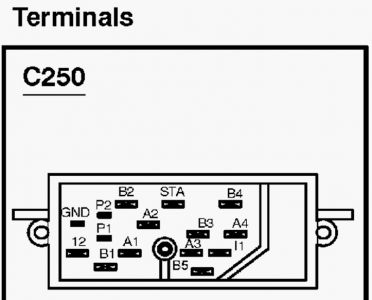

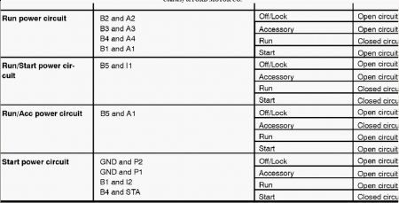

Apr 29, 2009 at 6:47 AM
MERLIN2021
  • 17,250 POSTS
While your in there test ignition switch.
https://images.2carpros.com/forum/automotive_pictures/62217_IGN1_1.jpg
https://images.2carpros.com/forum/automotive_pictures/62217_IGN2_1.jpg
https://images.2carpros.com/forum/automotive_pictures/62217_IGN3_1.jpg

Finally I have followed your instructions step by step.
1.) "Clicks", headlight flashes, airbag lamp & horn
problems:
I have checked all the grounds with the help of your
wiring diagrams.
Some of them were in a poor condition (covered with paint).
I cleaned them and I think this did the trick so far:
NO "CLICKS" ANYMORE!
2.) Braking lamps failure:
There was no water or corrosion in the connector
at the ABS module - I cleaned it just in case - but I
found a cracked cable which was connected with
the brake light switch.
I mended it.
NOW THE BRAKE LIGHTS ARE WORKING FINE!
