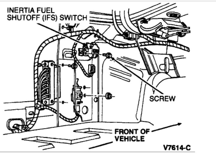

Cannot get car to start noram, can put a jumper box to the fuel pump, car starts. Unsure where the inertia switch is to test it.

its in the trunk on the side

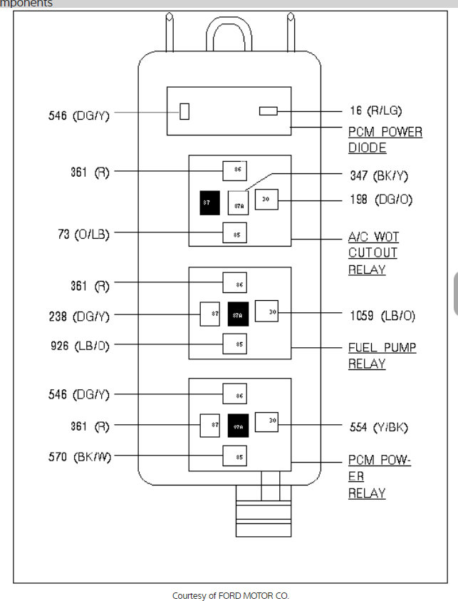

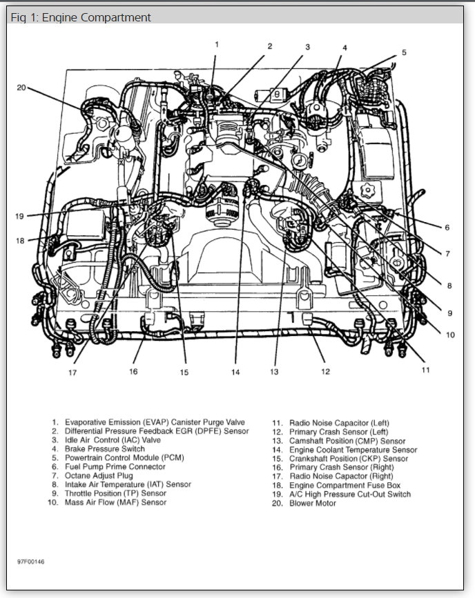

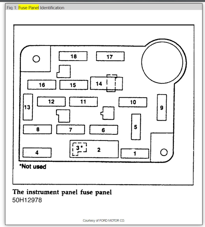

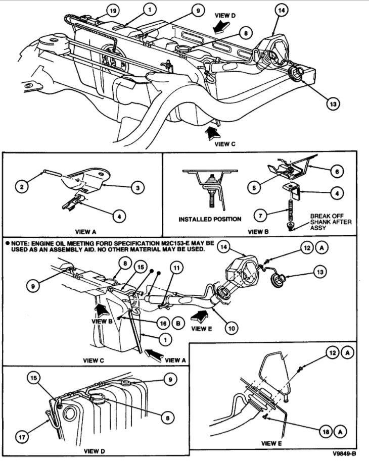

I own a 1997 crown victoria 4.6L police intercepter squad car and I need to know how to reset the fuel pump shut off switch mannually.The car has been sitting awile and I have replaced the plugs and put fuel in.It cranks but doesn't start,there's plenty of spark,all fuses are ok but ,like the other person,I too shot a little either into it and it fired up but didn't stay running. I couldn't hear the pump spinning as I was the only person working on it so it's impossible for me to listen for the spinning of the fuel pump.I believe either the fuel pump relay switch is bad or the fuel pump is bad,however I did something really stupid,I found the shutoff switch and I depressed the red button and now I don't know how to pop it back up also ,does anybody know how to drop the gas tank so I can replace the fuel pump if it needs to be replaced? thank you for listening to my long drawn out questions. :oops:
Jan 5, 2020 at 6:00 PM (Merged)
  • 54,841 POSTS

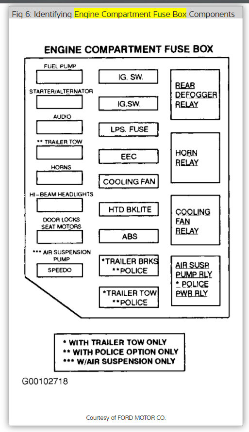

The inertia switch is in the trunk on the left side. There is a button on the top, press down! That's the normal position, to remove the tank you need to jack the car up high enough to get under the rear, between the axle and the tank you will see two threaded rods, undo these unplug all wires and lines and remove. (Check the diagrams below)
Do this with 1 or 2 gallons. The pump relay is under the hood in the power distribution box.
Here are some diagrams and guides to help you get the job done and put you back on the road.
and
https://www.2carpros.com/articles/how-to-replace-an-electric-fuel-pump
Please let us know what you find. (Check the diagrams below)

Push the button on top the switch located driver side trunk on sedan, inside the spare tire well on the station wagon.If the button goes down and stays down it needed to be reset ,if it won't go down it did not need to reset, if it goes down and comes back up {very rare}there is a short causing it to not reset.

Open the trunk, on the left side behind the panel or thereabouts is a switch. Usually there is some indication that it is there if you look.
