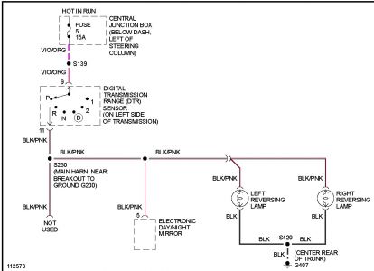

backup lights not working. bulbs appear ok.already replaced fuse.any idea's?
Jul 5, 2008 at 9:55 AM
SERVICE WRITER
  • 9,123 POSTS
You can check for power at the sockets with a test light, or try a bulb. Easy to get bit by assumptions. Check the range switch and the ground in the trunk.
