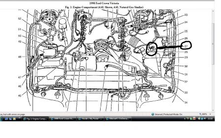

Where is the IAT sensor located on a 1998 Ford Crown Victoria LX? Is it built into the MAF sensor? If so, what color are the wires?

Intake Air Temperature (IAT) Sensor.....Left front of engine compartment.
https://images.2carpros.com/forum/automotive_pictures/266999_iat_1.jpg
