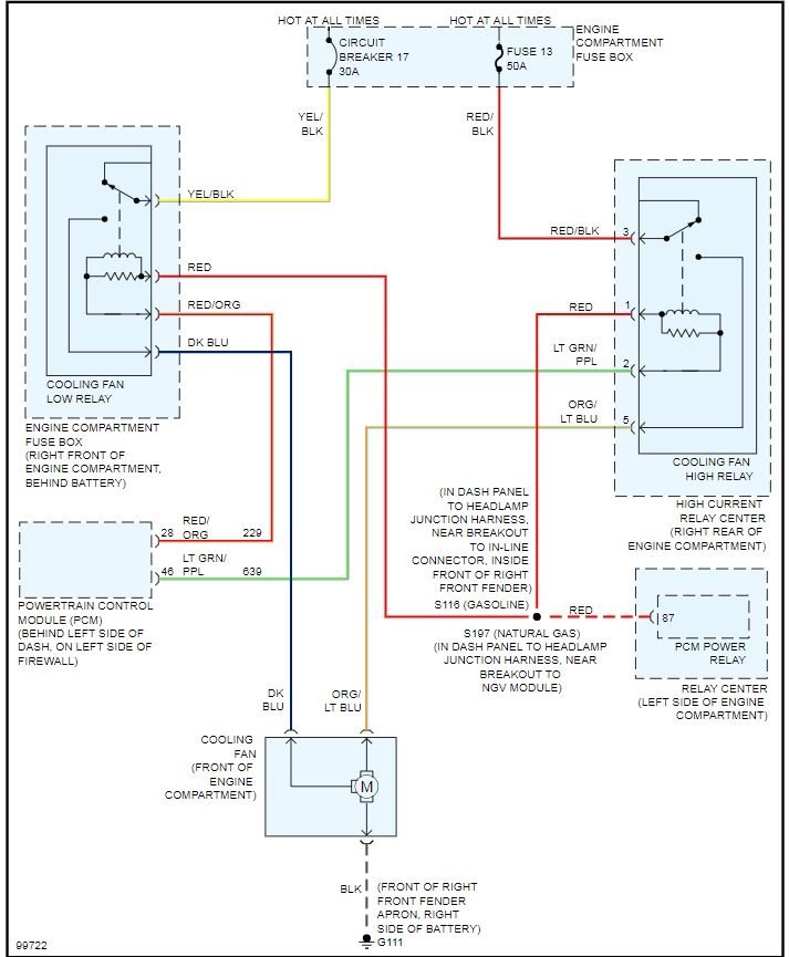

my cooling fan quit working.i replaced the sensor on the intake but i guess thats not what controls the cooling fan from coming on.it does work however if i keep the a/c on max a/c.its getting cold out and i need to beable to turn my a/c off.
