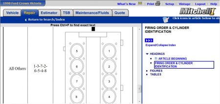

I recently inquired about changing a coil pack and spark plug on my crown vic. the help was great, but i may have changed the wrong one. The computer said #1 cylinder was dead, probably coil pack. I changed the drivers side front cylinder. Was this the wrong one? What is the #1 cylinder on 1998 crown vic? Thanks for your help! Ty

Check the sparkplug/compression/injector for no.1 Location of no.1 cylinder:
https://images.2carpros.com/forum/automotive_pictures/12900_fo_136.jpg
