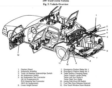

I need to change the turn signal flasher but cannot locate it to do so. Where is it? Thanks

Hello .. thanks for the donation .. much appreciated Hope this helps . .let me know Emergency Flasher Relay No. 1In left rear of trunk. See Fig. 5 . Emergency Flasher Relay No. 2In left rear of trunk. See Fig. 5 . Flasher (Front)Right rear of engine compartment. Flasher (Rear)Center rear of trunk. See Fig. 5 .
https://images.2carpros.com/forum/automotive_pictures/266999_cv_2.jpg
https://images.2carpros.com/forum/automotive_pictures/266999_AAA2_347.png
