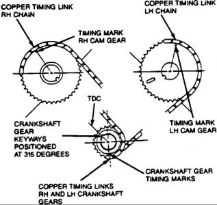

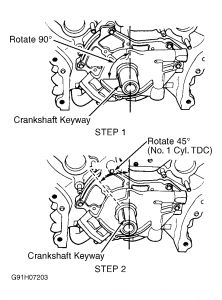

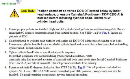

need to know how to set timing on engine just done a head job an the timing jumped

FIG. 8

Here is the cam marks to go along with the other post. The copper link is not really important unless you want to be sure both chains are exactly the same and not stretched.
