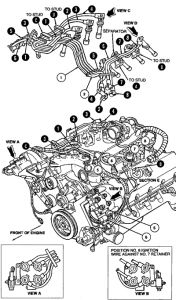

where are the spark plugs and coil pack located

The coil packs are located on the front of the valve covers on a braclet. You will see wires going into them. The spark plugs are located down inside the heads. Follow the wires and the spark plugs are under the end of them on the engine. If I were you, and you are going to change them, just do one at a time. Good luck.
https://www.2carpros.com/forum/automotive_pictures/382404_46_plug_wires_1.jpg
