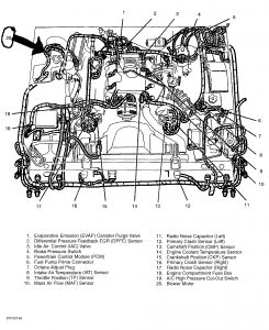

Can you tell me where the heater blower motor is located?

Blower Motor......On top right side of firewall. See Fig. 2
https://images.2carpros.com/forum/automotive_pictures/266999_blow_6.jpg
BLOWER MOTOR Removal & Installation Remove coolant recovery bottle. Disconnect battery ground cable. Disconnect blower motor wire ground wire. Disconnect blower motor lead connector from wiring harness snap-lock connector. Remove cooling tube from blower motor. Remove 4 retaining screws from blower motor mounting plate. Turn assembly slightly right so bottom edge follows contour of wheelwell splash panel. Lift assembly up and out of housing assembly. To install, reverse removal procedure.
